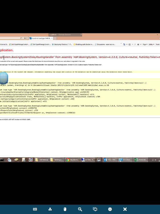

ful56_uk Posted July 3, 2014 Author Report Posted July 3, 2014 You shouldn't be getting logged in with the HAP user, it should log in with the user account if it's been set up correctly, if it hasn't then you have a kerberos issue on the server which isn't logging the user in. Is the user using IE? You should get to the home page and have be able to see this [ATTACH=CONFIG]25429[/ATTACH] Yes I get that message when logging in with ie. It's only using those URLs you said to use I was seeing this errors with the hap user
nickbro Posted July 3, 2014 Report Posted July 3, 2014 You need to make sure you are running hap v10.1
