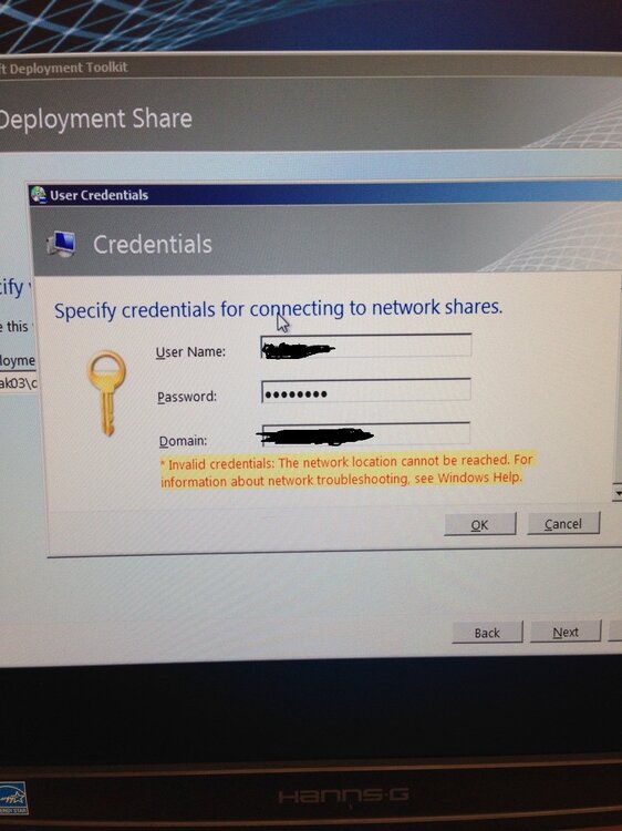

I seem to have a major issue with our deployment server. Last Friday I imported new drivers to the driver pool for some new PC's we bought. Since then, ANY PC which we deploy to, won't find the LAN driver, we have to manually add it off USB for it to continue the deployment. This happens for old computers which we haven't touched the drivers for. The new computers don't get the LAN drivers either. So today I updated the boot images, and now when I boot into MDT and type in the deployment share UNC path, and my domain credentials, it comes up with a message saying "Invalid Credentials: Network location cannot be reached". I have tried my own personal credentials, which have domain admin rights, and the actual domain administrator account, same error every time. Anybody got any ideas? At the moment, we can't image any of our new PC's, or even any of our old ones. I have even set up a new deployment share and tried connecting to that, with the same results.

Sounds like your lan driver isn't in your boot image, at the mdt login box press shift+f10 (i think) this will open a command prompted, run ipconfig /all to see if you have a network connection/ip
Interesting. As i mentioned, none of our drivers, new or old have been removed, only added. Ive put our driver discs in and tried reimporting, but no drivers get imported as they already exist. I tried what you suggested and it doesn't give me an IP address, im guessing that means it has no drivers? Even though the drivers are on the server boot images regenerated?
