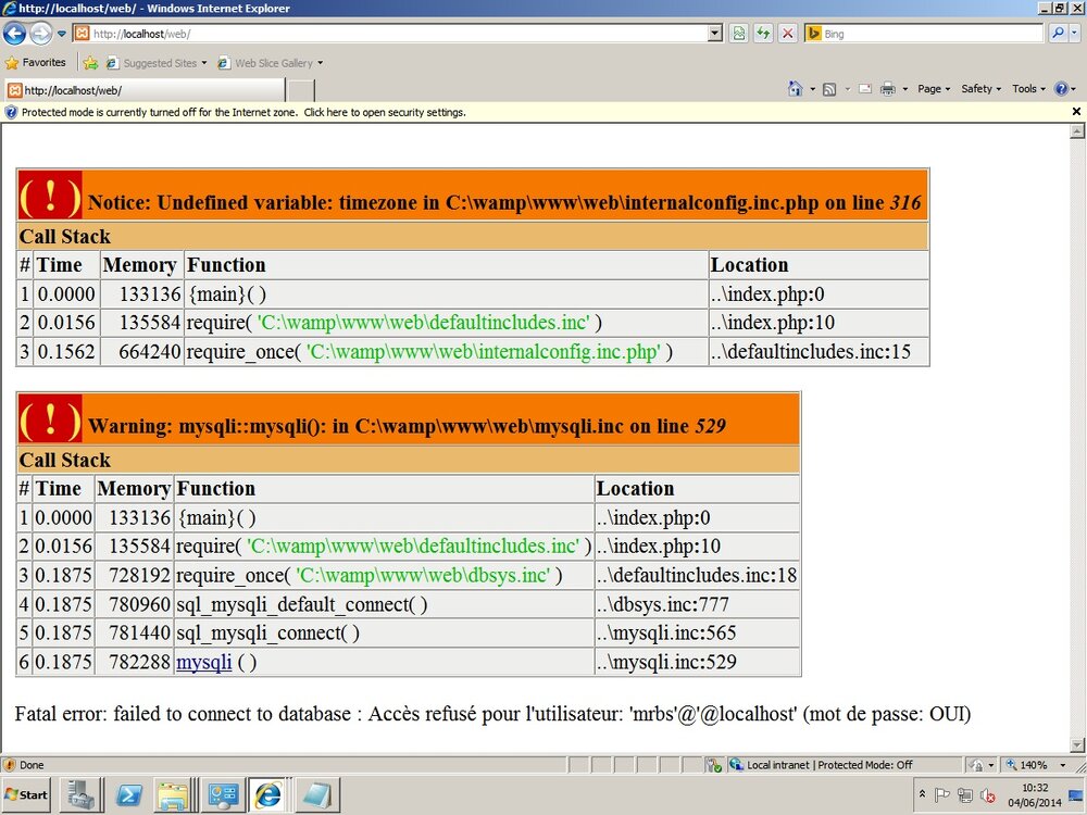

Ok here is my problem
After a few hours of getting wamp to install on my server 2008r2
I have all the services online (green icon) on the wamp server
I have done the following
using myphpadmin
created the database name mrbs
added the tables via sql menu copied the contents of tables.my.sql and run them as a query
tables have been created
added the sample data to ge me started
copied the web folder into wamps www folder
am i missing something
i get the following screen
where is the name and password for the user mrbs@localhost defined
the error at the bottom is telling me that access denied to the database for user mrbs@localhost
i am being really dumb but cant work it out today
Your top line you need to sort out the timezone in the config.inc.php, its an easy fix.
The second error implies it cannot access the database, so assuming your SQL is setup, you have appear user called mrbs that cannot access the mysql proper.
Check the database login details, the 'mrbs'@'@localhost' doesn't look quiet right to me...
