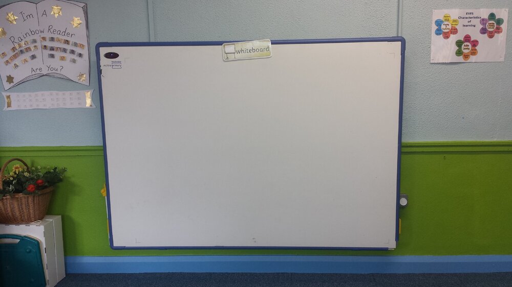

I have a old promethean board with the serial connection to the computer. The board is constantly flashing red top left corner of the board. When I unplug the board from either back of the board or PC it make a noise. I have tried uninstall and reinstall active inspire but no luck. I have also tried 2 other PC and the same issue and also downgraded the software. Any idea how I can resolve this issue? Or is the board too old and needs replacing. I have included a picture of the board above:

Thank you for the photograph this allows me to know the board type you have got, in your case the board is what we call AC1 (1st Generation).
