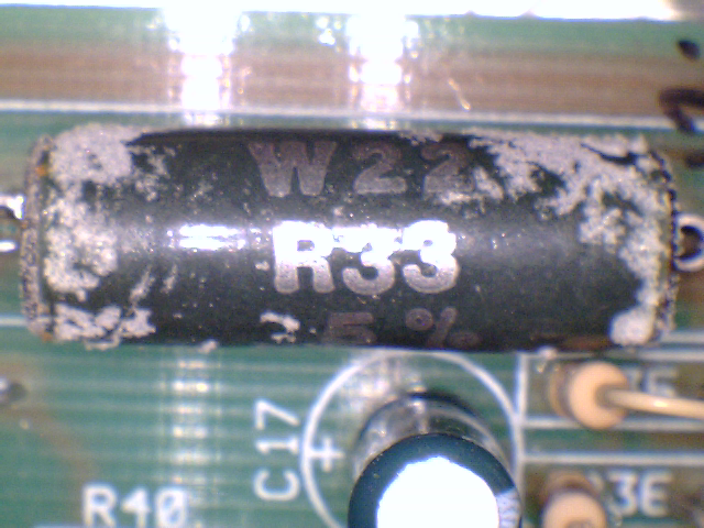

One in particular caught my eye, it's a Carlsboro GLX-85 Special Edition (actually not that special by all accounts and not worth a great deal) so I thought I'd take that in to the house clean it up, dry it out and give it a blast! I thought I could even donate it to the school if it was any good. Unfortunately I was disappointed, it sounded horrible the controls were scratchy, I couldn't turn off the distorted sound and had loads of drop-outs, it sounded like the sound was struggling to come out then blasted at full volume...
TL;DR
However, I have taken it apart like a good geek and found nothing really amiss, apart from two components marked W22 R33 5% on the rear circuit board and they looked corroded. I have attached pictures, but I don't know what they are, where to get them from and how easy they are to replace. I looked a little on the net, but didn't find anything that looked the same. I don't have any circuit board/component level soldering experience, but I don't think the amp is worth the money to have it professionally repaired... Also, if I do change these it might not solve the problem, but if I try I might make it worse or destroy it completely! HELP!

Yeah, I saw those ones based on the W22 & R33 markings. My concerns (knowing nothing about them) was about what they meant and if the other markings were pertinent, like the 5% bit or the online ones being 7W or JI...

That component is a 0.33 ohm resistor and is unlikely to be the cause of your audio problems. Try to clean / replace the potentiometers and as others have said, check for bulging capacitors.
