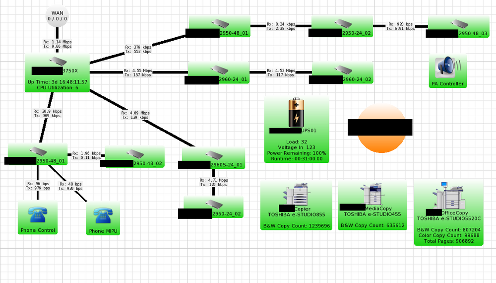

I cannot stress enough for the need to setup some kind of network monitoring software; aside from alerts and the peace of mind that comes from it, it'll help out immensely with troubleshooting. There is no need to spend money on this either as there are plenty of good, free alternatives. I'm using The Dude in my district and have every single network device and server across seven buildings setup in it with reporting on UPS units, core/edge switches and even temperature in data center. Included is a map of one of my smaller buildings. Traffic is logged and graphed between all switch links and has already aided me a couple of times in diagnosing issues with a few being broadcast storms. I get the occasional staff member that decides to bring a dumb switch into their classroom where they promptly introduce a switching loop causing a broadcast storm. Trying to find the source in a large building without a monitoring setup would be a lesson in futility. Just glancing at the map I was able to see what switch it was coming in off of, and opening the switches properties allowed me to see the exact port. This is just one time this has made my job a lot easier.

That I've found yes, but The Dude doesn't look like it is being actively developed anymore. Mikrotik has been silent in the forums regarding it's development for a couple of years now. It still works though and I see no reason to look for a replacement.
