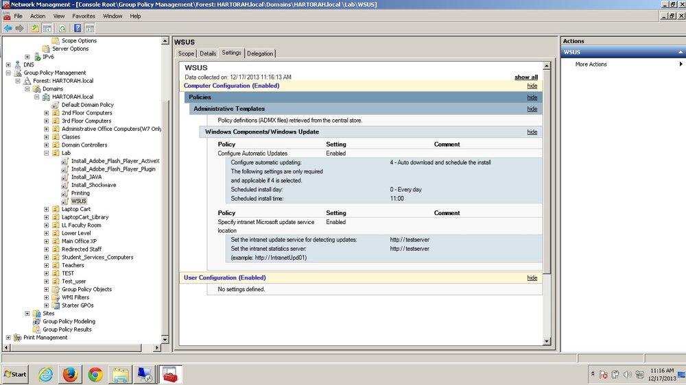

Can you screenshot the GPO? Have you put in details like the network location of the WSUS server (http://servername - the port number isn't needed on 2008 R2)? Once restarted, you can force a detect run by batch using wuauclt /detectnow.
Here you go: wsus.jpg
