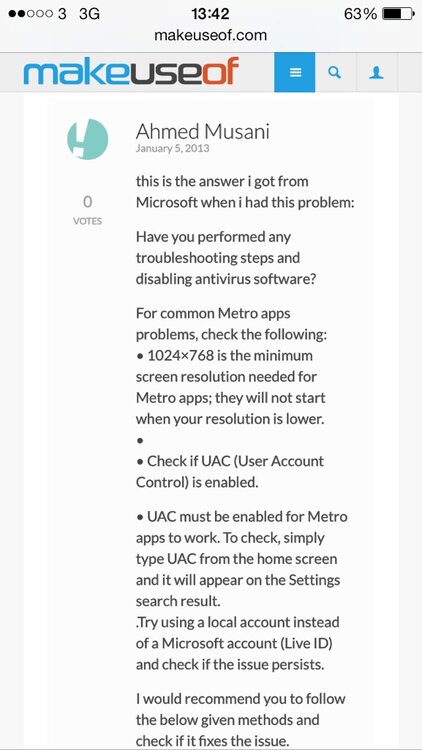

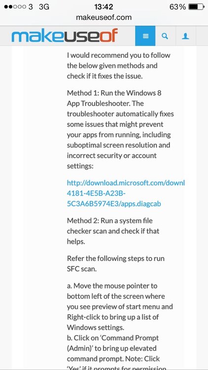

Yeah I googled the issue and found the same page :-)
The only thing from there I think it can be is the UAC settings which apparently have to be enabled. I have fiddled with it and tried all the different settings but no luck. I'll have a look at the drivers stuff you suggested as well, thanks for taking the time to reply.

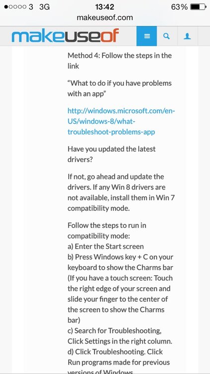

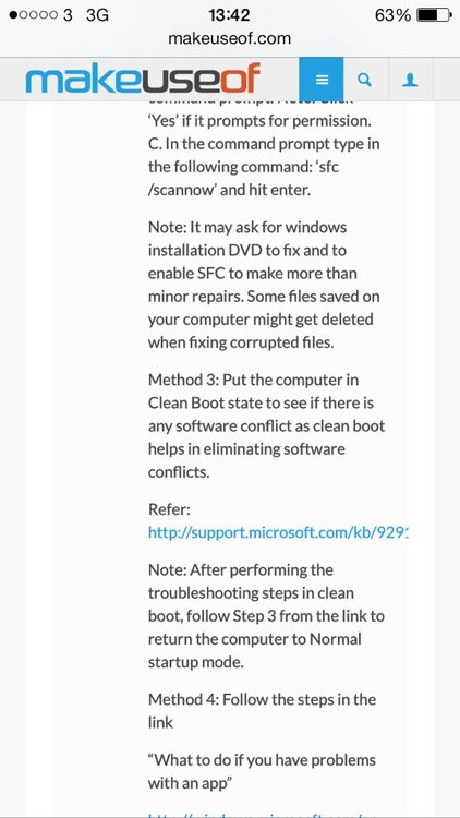

No problem. It does mention in step. 4 ref drivers
In the 4th screen grab I believe as per the long reply from that thread
My bad, so it does! I missed that bit completely going round and round with Windows 8. A case of RTFGA rather than RTFM - cheers!
