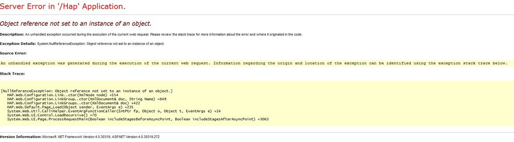

As soon as I try and edit hapconfig.xml file with my info (what files can be uploaded, drive mappings etc) I get Object reference not set to an instance of an object error again
You will need to configure HAP+ again using the basics, a fair few settings have been changed which the upgrade script would of changed, but obviously it doesn't work sometimes. Sorry to say :-(
No worries, just thought I would say. There must be something in there that has changed, I am trying to figure out which line of code is the issue to report back.
