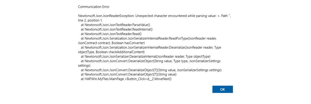

Trying to set this up and had this error at first:
All I have changed is the url that points to my server and now getting this:
Communication Error
System.NullReferenceException: Object Reference not set to an instance of an object.
at HAP.Win.MyFiles.MainPage.D_2.MoveNext()
any suggestions appreciated.

On further investigation I have found that if I remove my redirect aspx from wwwroot:
response.redirect("https://schoolname.co.uk/hap/default.aspx")
Then the error reverts to the original message in my first post.

I am getting the same error - I am running a trial of the app to see if it works. Is it a formatting error? https:\\domain.name\hap\
Username is DOMAIN\username or just username ?
Issue found, add this to your web.config:
Will be fixed in the next release of HAP.Web and HAP.Win (v1.2 for 8.1 is going through certification atm)
