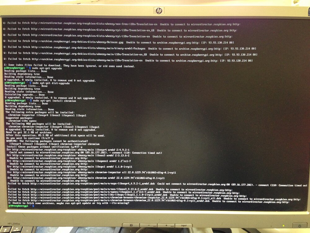

We have recently had some Raspberry Pi delivered and I have been given the task of getting them ready in order to show ICT teachers what they can do. Unfortunately I am not able to download anything at all, I thought I'd start by installing Chrome for Raspberry Pi by running the "sudo apt-get install chromium" command but it failed with the following error "unable to connect to mirrordirector.raspbian.org:http:". I have attached a picture of the error.
Please help
Rav
If you're doing this from within a school network did you set any of the proxies on the Pi? Else it wouldn't be able to connect through to the internet.
Steve
Are you behind a proxy? If so, you'll need something like 'export http_proxy="http://proxyname:port" and search this forum for apt.conf which will also want a proxy setting which I can't remember off the top of my head.

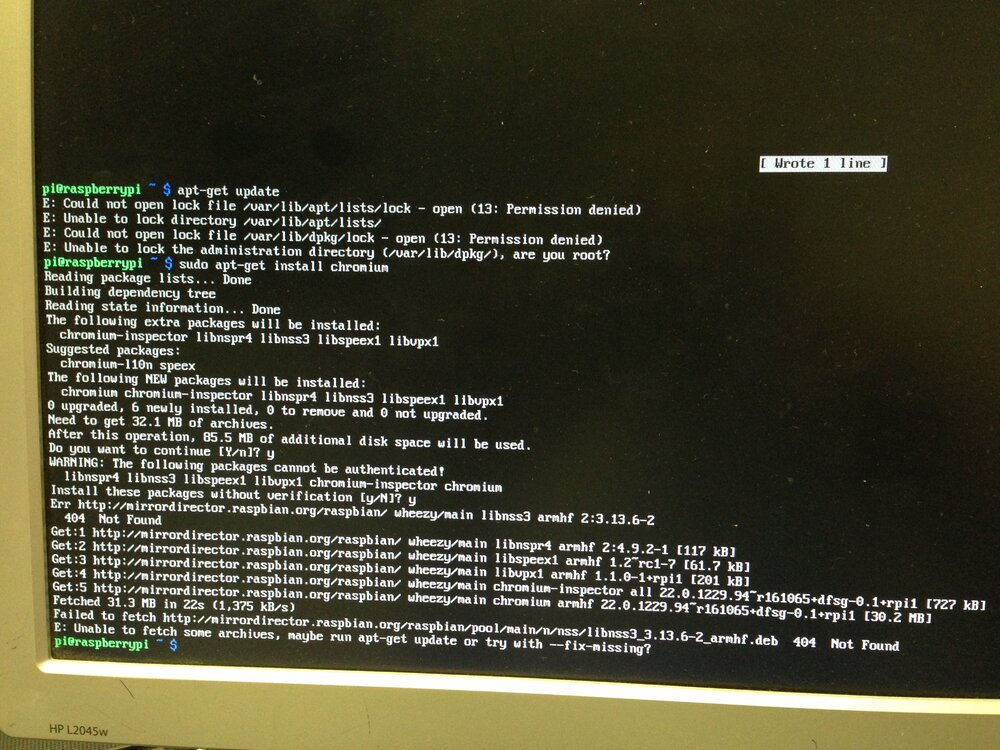

Thanks Mats for your reply, I have entered the command and have managed to pull some files down but others have failed, is this normal? I have attached a picture please let me know what you think.
Many Thanks
Rav Singh
Many Thanks
Rav Singh
P.S I got "apt-get update" working and is update now, I had to change user to root by using "sudo bash" command.

So, a quick explanation of what happened. When you run "apt-get update" as user pi (your normal login user), apt-get can't write the files it needs to write because it's just a normal user.
When you run "sudo apt-get update", it runs the same program as the super-user aka root, who can write where it wants.
Normal stuff - use the pi user.
Admin stuff - sudo.
When you type "sudo bash", it runs bash - the command line interpreter - as the super user, with its almighty powers.
