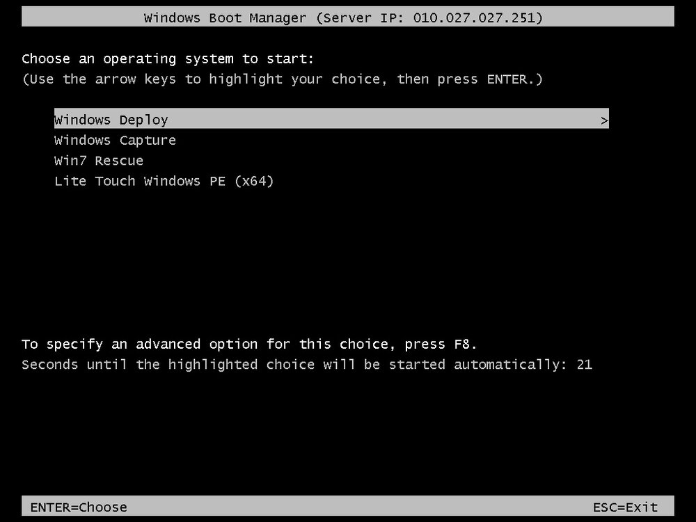

fiza Posted May 8, 2013 Author Posted May 8, 2013 [ATTACH=CONFIG]18137[/ATTACH] is an example of the menu where i am Going back to this menu. Does each item relate to a different deployment share? If so when you capture an image do you then need to transfer it to the "deploy" deployment share?
sted Posted May 8, 2013 Posted May 8, 2013 Going back to this menu. Does each item relate to a different deployment share? If so when you capture an image do you then need to transfer it to the "deploy" deployment share? in that case no windows deploy is a wds boot to deploy xp images windows capture is a wds boot to capture windows xp pcs windows 7 rescue is a network bootable version of windows 7 with a gui and various tools to fix pcs or at worst yank data off without me having to find a cd/dvd/pen drive to boot from the bottom one is my mdt boot don't have any captures there iirc or if I do the boot image is hidden as I don't need it atm
