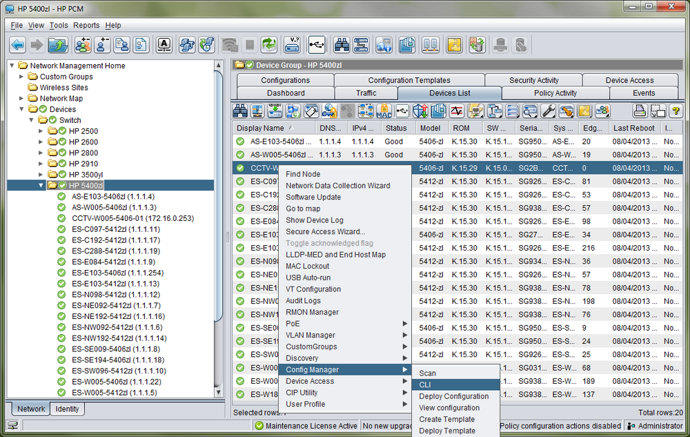

Have you set the switches host name and system name properties? Are the switches configured to use DNS for name resolution? Remember PCM is just a management front end to the switches themselves.
If not, you can push out something like ip dns server-address to all the switches via PCM's Config Manager --> CLI wizard for DNS and, likewise with the hostname and sysname commands for those settings but obviously those will need to be on a 'per device' basis.

Glad you solved it Gongalong - you can log onto each switch via the command line and issue commands to configure any aspect of the switch, and that's what I was talking about - hostname and sysname are commands in that environment.
You can send commands of this kind to one or more switch in ProCurve Manager by selecting the switch(es) via the devices list, and using the CLI menu option, or you can log onto the switch via a SSH or Telnet connection (one or both of these must have been configured or else PCM wouldn't work).
