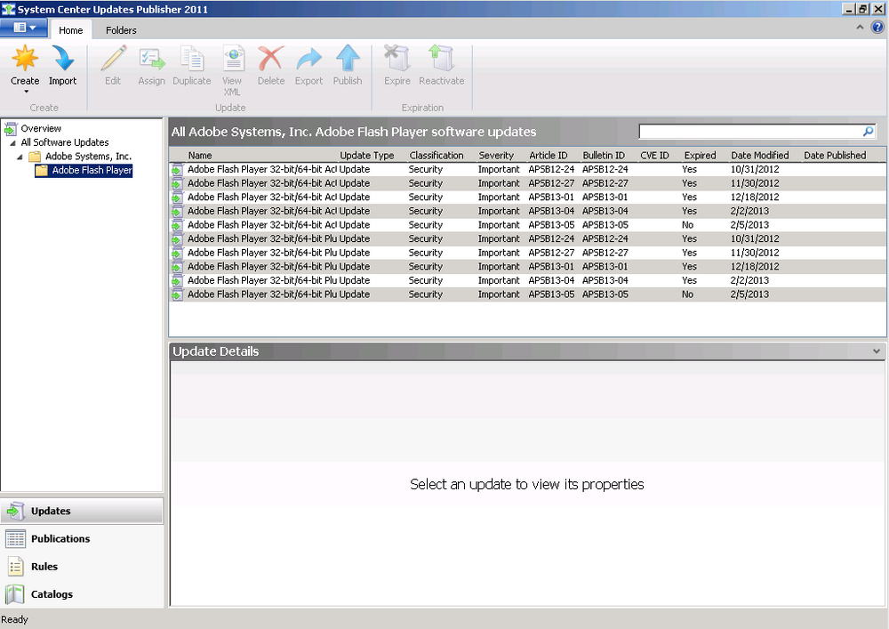

This is what was giving me the issue.
I have imported them and I can see them (see attached), what do I have to do for SCCM to see them. I have looked in SUP on SCCM for flash and can't see it (see attached)
Would I have to keep using SCUP when a new release has is available? Would they not just come right into SCCM?
Thanks
Edited by FN-GM
You will need to go into SCUP to check - it will show up in the Overview tree under Recent Alerts
You should see the Adobe Branch there once SCUP has published - IIRC @localzuk said this took a while..
Also, make sure you run a full Update Sync to get the updates down...
Have you run the ConfigMgr integration and made sure its working?
I didnt publish :doh:
