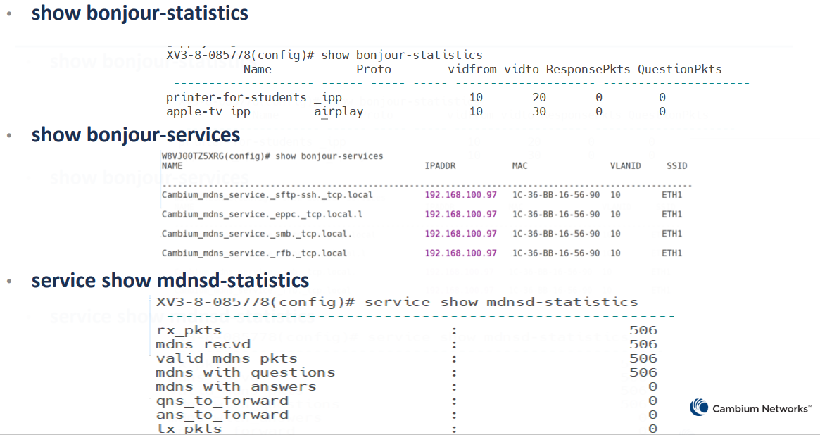

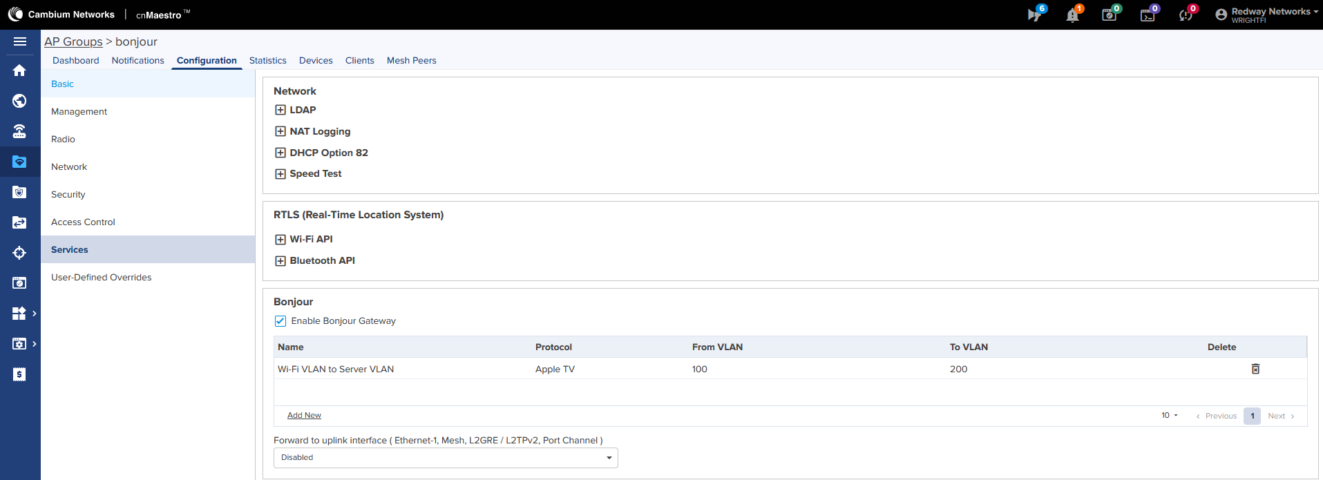

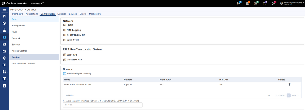

Airplay across VLAN - Cambium and Meraki
RedwayNetworks_Michael replied to snagrat's topic in Wireless Networks
Hopefully the below may help You can use the Bonjour Gateway to allow AirPlay traffic to cross VLANs, for example: Also, here are some useful debugging CLI commands you can run on the AP if you have any issues. -
