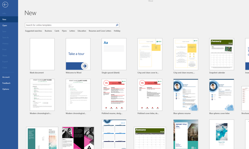

  10. Hi everyone, I'm looking to see if it's possible to change the suggested templates that appear whenever you open up an Office 2019 ProPlus application such as Word, Excel etc. Currently and by default it references Microsoft's own suggested templates (as per screenshot), presumably from their online store. What I'm looking to do is instead offer staff the standardised templates such as documents for students, documents for staff, letterheads etc. in order to facilitate staff using these, rather than going off-brand with their own quirky and oft-awful IT skills. These could be stored within Sharepoint or on a local file server. Is this possible to do? Many thanks in advance.

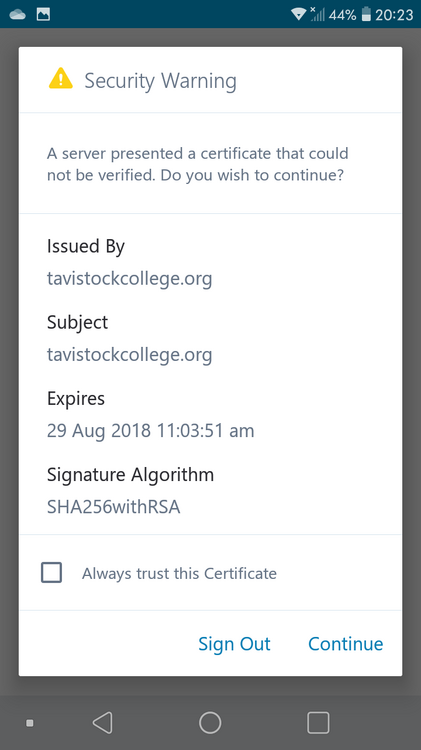

  11. Hi everyone, I have an issue in Skype for Business - seemingly only on Android - where the following pops up when staff install and sign in. We're not even part of Tavistock College or their MAT, so I'm not sure what the hell is going on here. Closing and reopening the app a few times, signing in from scratch each time, eventually makes this disappear, but I have no clue why it is even appearing in the first place! Anyone else come across anything similar? We will roll out Teams in the very near future which will render this all null and void, but this is just so people can keep in touch and discuss school business via video conferencing without having to use another third-party piece of software such as WhatsApp, Zoom etc. in the meantime.
