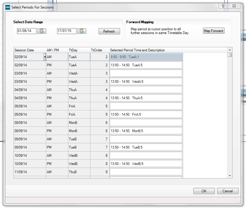

  17. Right, this is now sorted, thanks to all for the help offered. And what did Capita say? Try running the mapping on the server instead of a workstation. It worked first time! But... I didn't have to do that last year, or with PM registration this year, and my workstation isn't the only one I've tried it on... wha?!
  18. Unfortunately we don't have those menus! This is the screen I mean. Pressing Map Forward doesn't do anything and even setting all the AM ones manually won't be saved once it's closed:
  19. I've asked County to contact Capita. We now have one day in which to have them do so and for Capita to respond with a solution (assuming it's as simple as "oh yes, this is what you do"). Which it won't be.
  20. Afternoon all... I'm having a very serious issue with SIMS if anyone knows what could be up with it. We've previously had the AM attendance session mapped to morning registration and the PM session mapped to Period 4. We've now changed the school day and need AM to map to Period 1 and PM to map to Period 5. There's a Form Time period after Period 5 but it's not used for registration. We're having to do it the "Tools > Setups > Attendance Setup > Registration Organisation" way because that's how PARS integrates with it. We don't have Lesson Monitor. Mapping the PM session to Period 5 is working fine... but the AM session will not map to Period 1! Nothing happens when I press the Map Forward button; it doesn't populate down the list. I've even tried setting every single one manually and saving, but when it re-opens the mapping isn't there and PARS doesn't show it as mapped either. I really can't work out what could be causing the one to work but not the other! County Support don't know either. All I do know is, if it's not in place and working for Tuesday morning, a Great Doom will settle over us as we won't have any AM attendance data until it's fixed... :/
