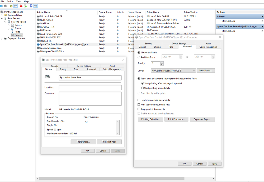

Heyo. Changing driver settings and maintaining compatibility across a range of devices can take a bit. Maybe create a new queue and test the settings there? I'm pretty sure snagrat is talking about the General -> Preferences and Advanced -> Printing Defaults settings.

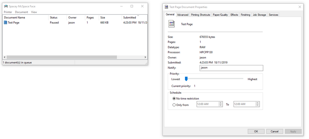

Hey @kennysarmy Only just saw this thread (been on leave) sorry... If the "available from" hasn't fixed it... Lets dive in. So.. Steps are: 1 - Print to hold/release queue 2 - Go home without picking it up. 3 - Come back next day, nothing is showing on the PC/Laptop 4 - Go to copier, release job. 5 - Nothin' happens at the copier 6 - Go back to PC/Laptop and the PaperCut User Client has popped up since 7 - Do the account selection etc. 8 - Go to copier, release job, receive print out Is that about right? If so, thats pretty exorcist-level strange. What version of PaperCut are you running? Are you using the stand alone release station? Web based release station? If it's the copier embedded, what copier platform? What printer driver are you using? Does it happen to all PC/Laptop/Users? I'll try and reproduce internally, but we do have a seriously large number of customers that have multi-day hold-release queue settings, support would have been hammered if this was a common problem.. That said, the "available from" strikes me as odd... So I asked around. This is something new that happens on some queues that PaperCut manages. This is done to better support some, uh, "high volume environments" that measure paper consumption by the pallet.
Something to check is that the username attached to the job, as the print spooler on the server sees it. See attached: Check the Windows Credential Manager on the affected machine(s). Failing that.. Two KB articles we have that are good to run through: https://www.papercut.com/kb/Main/UserClientPopupAndNotificationIssues https://www.papercut.com/kb/Main/PrintingNotBeingTracked I apologise for the length of those KBs but they do cover off a heap of things to check. Next step is probably to contact PaperCut Support ( http://www.papercut.com/contact/ ) They (I'm in a different area) will likely want debug logs :-) Namely: PaperCut Application Server Debug: https://www.papercut.com/kb/Main/HowToEnableDebugInNG PaperCut Print Provider Debug (this may be on the server only, but may be on client machines): https://www.papercut.com/kb/Main/HowToEnableDebugInThePrintProvider PaperCut User Client Debug: https://www.papercut.com/kb/Main/HowToEnableDebugInTheUserClient The above is a fair whack of work but gives immense detail as to what is happening. You'll want to: 1 - Enable debug in the App Server 2 - Enable debug in the print providers 3 - Enable debug on both user clients 4 - Restart the client machines, make a note of the time/date. 5 - Print a print job that gets the popup on the wrong machine, make a note of the time/date username expected, hostname of the machine. 6 - Bundle all the logs together 7 - Turn off debugging if you wish
