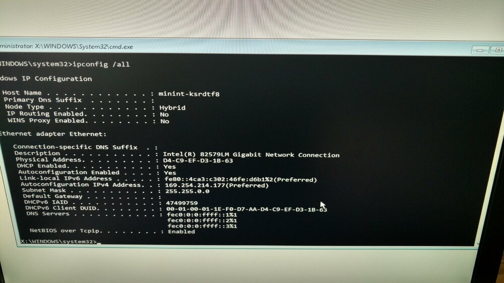

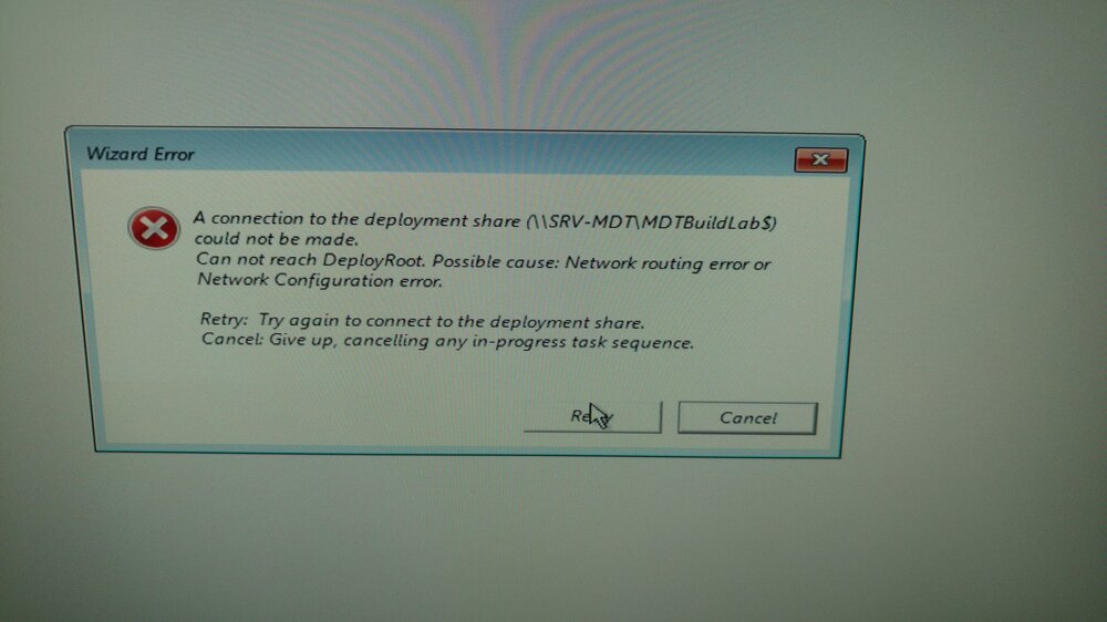

  9. That is what is exactly happening to me, only I'm losing my IP address when it goes into the MS Solution Accelerators screen.
  10. So before I left work I added the drivers to the wds boot image. When I pxe booted and got to the task sequence it failed again with the same error. This time though when I did an ipconfig the machine received a request. I also tested a ping to the MDT server with success. Tomorrow I will verify if I can manually map a drive to the deployment share of the MDT server.
  11. should I also add those drivers to the wds boot image?
  12. I'm having some issues getting my machines to image correctly. I'm pretty sure I have the vlan side of things figured out. I followed this thread http://www.edugeek.net/forums/enterprise-software/157848-issue-mdt-wds.html and added in both the IP helper addresses. What I'm running into is when I get into the task sequence of MDT I get the following error. Now that all makes sense because if I do an IPCONFIG /ALL I see the machine doesn't have an ip anymore. What I don't understand is why does the machine lose it's IP address? It grabbed the correct one when PXE booting from WDS. I also added the drivers for the machine I'm testing everthing on updated the deployment share, then replaced the image on WDS.
