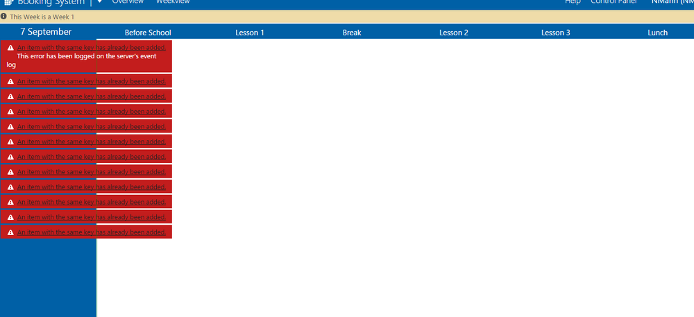

Urgent Help - Booking Sheet error - static bookings!?
Manny21555 replied to Manny21555's topic in Home Access Plus+
Hi All, I have fixed the issue we have two bookings the same which was the problem, I removed both and went back onto the booking system and it works! Cheers, Manny -
Manny21555 posted a topic in Home Access Plus+
Hi All, Its that time of year where we are updating the booking system (timetable). I've ran into a serious error (students are back next week & we cannot see our timetable). I've manually entered the new dates/lesson on the booking system via booking system home>static bookings. We are receiving an error when going to the dates (we also cannot see any timetable at all, please see attached picture) I did not import them from SIMS just deleted the old bookings via the static ones and then added new ones in. I need help with this as I'm no expert! Cheers, Manny -
