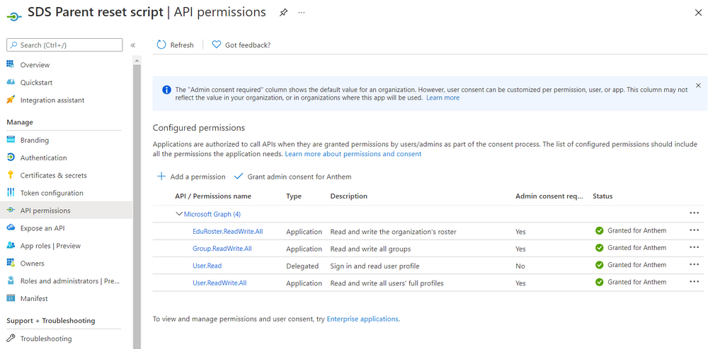

  12. https://github.com/OfficeDev/O365-EDU-Tools/blob/master/SDS%20Scripts/Reset-Guardians.ps1 I booked a call with MS support to help me register an application API in Azure AD for the script. It includes adding the required permissions on the API registration for the script to run with.
