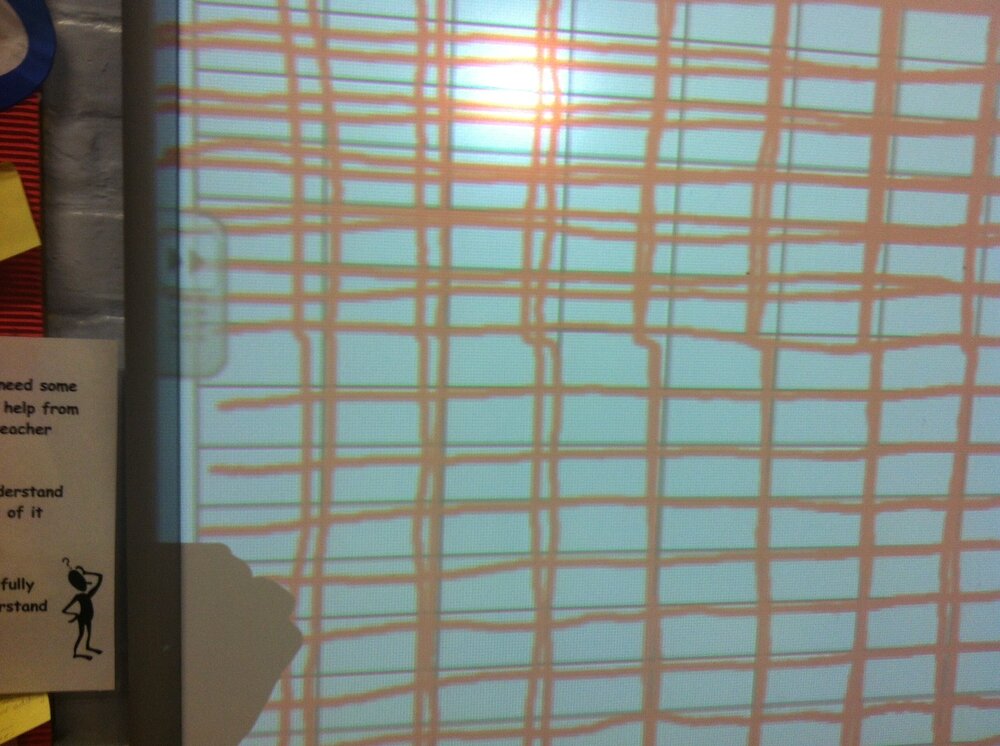

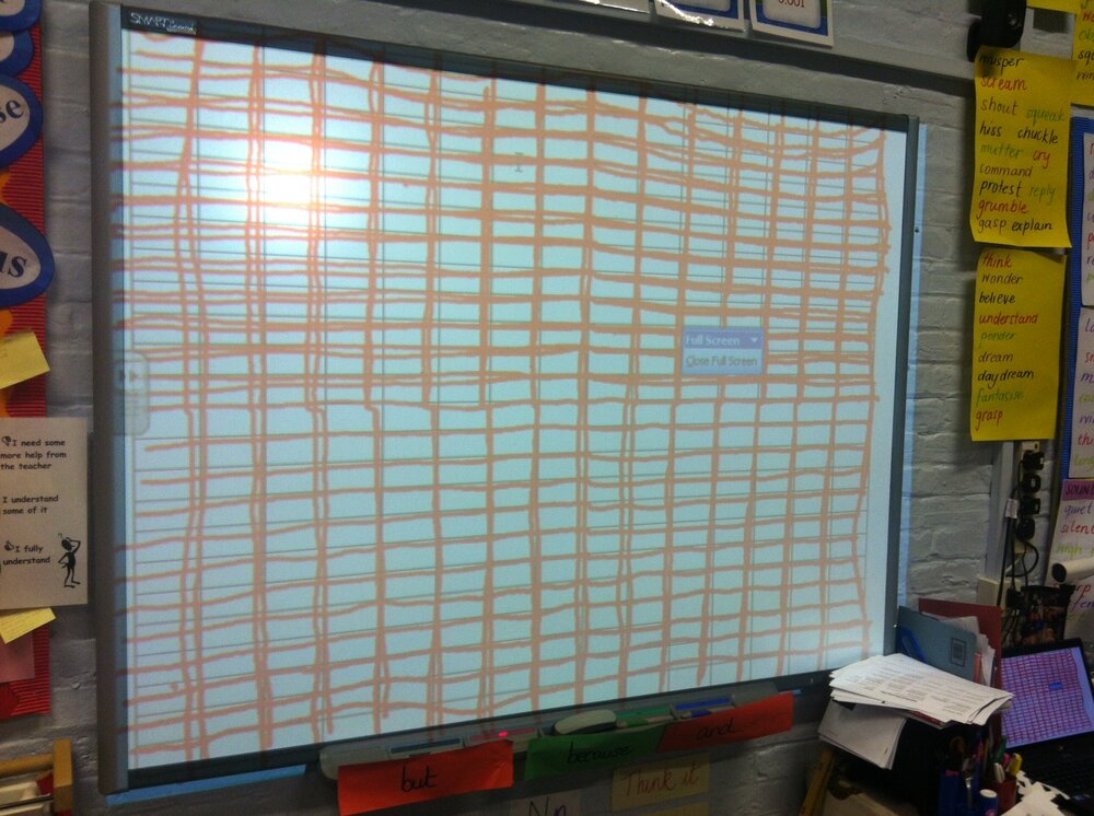

  • Occupation

  8. Hi guys, Got a Smartboard SB660 with a very peculiar problem and wondered if anyone had come accross something similar. Basically the whole board is pretty much always mis-aligned and orienting the board doesn't seem to help. The left side will be off about an inch one direction, the right another, corners and other points will be off too. I have included pictures of by attempts to trace a grid to help clarify - please see attached. Unfortunately board is out of warranty. I've tried upgrading software/firmware, resetting controller, loosening screws, taking board of wall, visibly inspected for dents etc, re imaged machine/tried a different machine but the outcome is always the same. Anyone experienced anything similar to this before? Kind Regards, Andrew
