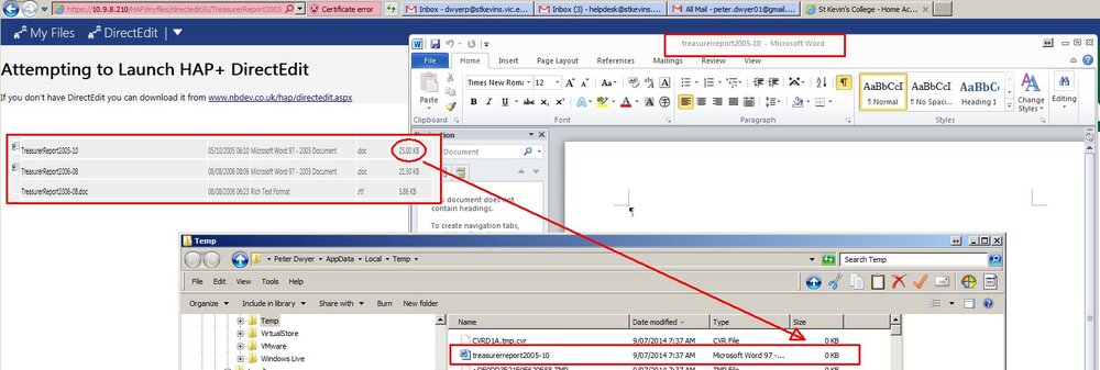

  2. My issue reported on 9th July seems to have fallen through the cracks. Although DirectEdit is a "nice to have" feature, it's not mission-critical for us. I still can't get it working. Refer to the image in my previous post. Although the file *appears* to download to the %temp% folder it actually downloads as a zero-byte file. I wonder if the fact that we are using a self-signed certificate might contribute to the problem (server is still in testing). Or, perhaps might a Proxy Setting or local security setting/policy be getting in the way of downloading the files for editing? It's certainly not security access as most of the files tested are in my home folder. Any suggestions would be appreciated... Thanks
  3. Thanks for your reply. I've tried it on both MSIE (v11) and Chrome (v35.0.xxx) and had the same result. Thinking that our Group Policies might be affecting the application, I even tried it on the Windows XP machine that I keep salted away for testing :-) Still got the same result that is, DirectEdit appears to believe that it has downloaded the file but it's actually downloaded nothing. I've attached a screen shot (overlaid with directory listing) showing that there is a zero byte file in %temp% If you need more info, please ask... Thanks
  4. I've also tried DirectEdit with my 10.1 installation. It installed and seemed to integrate with HAP OK. It started the application (MS Word) when I chose a document and right-clicked "DirectEdit", but it only showed a blank document. It's as if it hasn't downloaded the document to the application I've had a look at ~/MyFiles/DirectEdit.aspx and there doesn't seem to be anything that's configurable. I know I'm probably missing something but don't know what. Is there any documentation? Thanks
