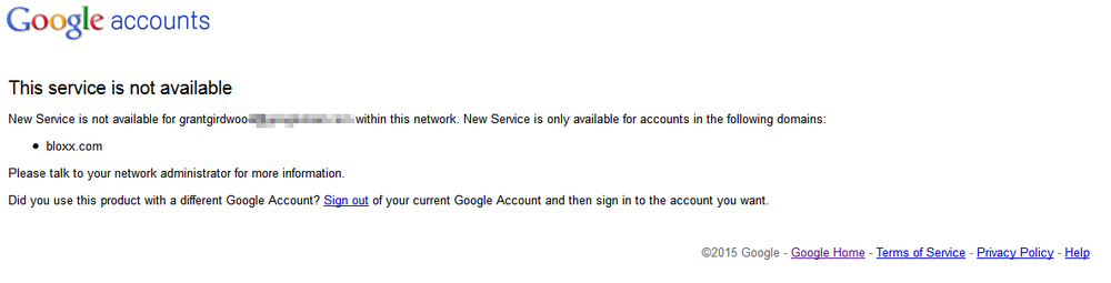

  22. You can restrict logging in with consumer accounts by modifying the header in the request - https://support.google.com/a/answer/1668854?hl=en Which would result in the below... http://i.imgur.com/whzUZXR.png It does appear to be a backwards step geared to getting more schools to sign up to Google Apps for Edu..
