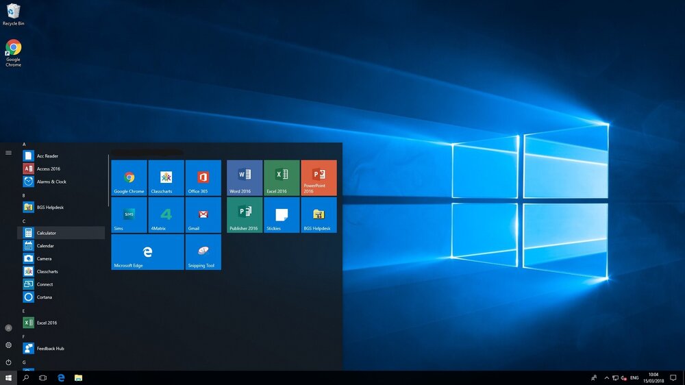

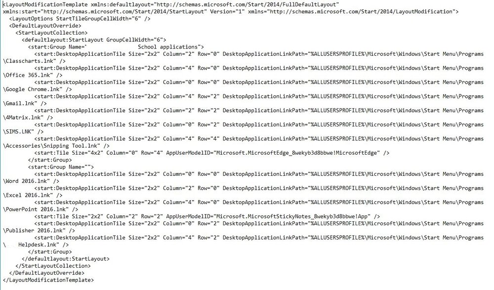

  8. Hi, We have been using Windows 10 for a while now, originally I set it up with classic shell for the start menu/programs and used folder re-direct to a file share so everyone gets the same experience (basically works the same as windows 7). I am currently building a new up to date image and was wondering how everyone else manages the start menu? Am I best of sticking to Classic shell or is there an easier way to do it these days? Thanks

  14. This is what ours looks like: We will probably add more at some stage, but these are the most used.
  15. Our staff desktop is minimal as we place everything on the tiled start menu, works well and keeps it tidy.
