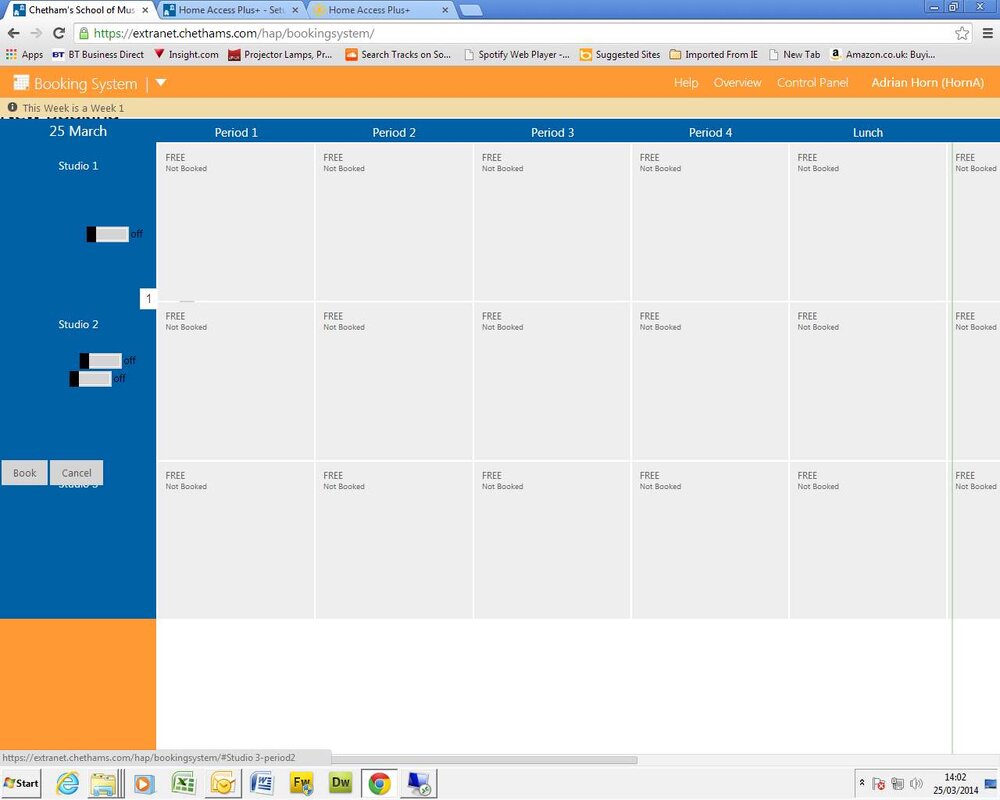

  11. I've found the CSS for changing the background colours depending on whether it is booked or not: #bookingday .body .col a.free { background-color: #58fa58 } #bookingday .body .col a.booked { background-color: #fa5858 } Just need to sort out the sizing of the bookings page now.
  12. Found a reference to fitting more on screen in the forums with a post from you Nick saying to alter line 69 in the bookings default.aspx: style="min-width: <%=(200 * (config.BookingSystem.Lessons.Count + 1)) + 2 %>px"> However, we have 10 booking periods, and altering the min-width does make the width smaller, but, for example, if I change the min-width to 100 then it looks how I want it but only shows 7 of the booking periods, if I leave it at 200 they are wider and need to be scrolled to see, but shows 9 of the booking periods. If I set it to 300 then I they are wider still, but with a lot of scrolling shows all 10 of the booking periods! How can I get it so it is small width, but showing all 10 booking periods?
  13. Thanks Nick, I must have messed up some CSS at some point before using the Booking System. Put a fresh copy of the CSS back and it works fine. I remember seeing somewhere in these forums 4 lines of code that showed Bookings with a red background and Free's with a Green background (and I think statics with a different colour as well - although i could have imagined that) but I've tried searching and I can't find it any where. Does anyone remember seeing it on the forums? Also is there any way of making the Bookings smaller so I can fit more onto a screen without scrolling? Cheers Adrian
  14. Hi all Looking at getting the Booking system in HAP up and running so we can use it to book our 3 recording studios. Added the School periods, the resources (rooms) etc, but when I go to look at it I get this Anyone figure what is happening on the left-hand side. There seem to be some toggles, but I don't know what they do, and the BOOK and CANCEL buttons are obscuring the text for Studio 3. Ideally, I'd like to make all the columns narrower so that I can fit all the bookable periods on screen without having to scroll right. Is that possible? I couldn't find any CSS. Any help would be appreciated. Cheers Adrian
