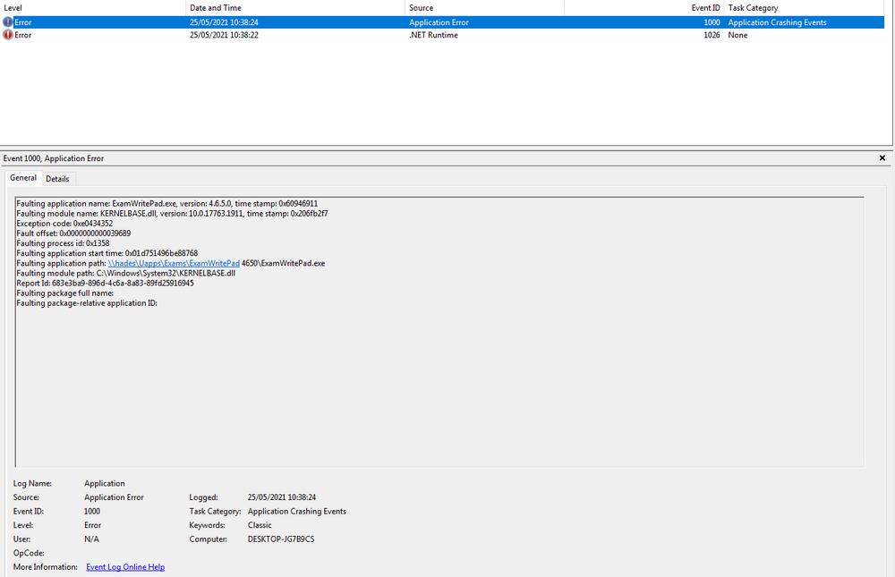

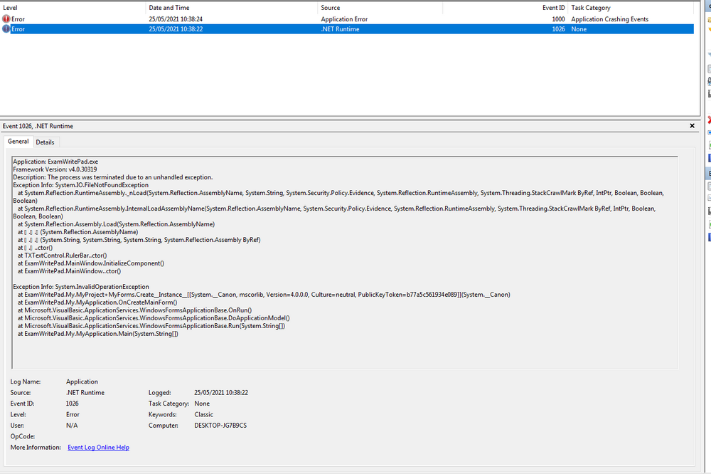

  3. just downloaded to test latest version and cannot open EWP "ExamWritePad has stopped working" previous version works ok (v22.05.11.1525). Thought it was due to my changes made to the json file but also get same error using unedited original json file.... Faulting application name: ExamWritePad.exe, version: 22.6.1.1000, time stamp: 0x6293b153 Faulting module name: KERNELBASE.dll, version: 10.0.17763.2928, time stamp: 0xb94797c5 Exception code: 0xe0434352 Fault offset: 0x0000000000039319 Faulting process id: 0x1504 Faulting application start time: 0x01d8798a1f1e6dee Faulting application path: C:\Users\****\Downloads\ExamWritePad\ExamWritePad.exe Faulting module path: C:\windows\System32\KERNELBASE.dll Report Id: 8499e031-f0e8-4428-9027-182c4848808b Faulting package full name: Faulting package-relative application ID: Application: ExamWritePad.exe Framework Version: v4.0.30319 Description: The process was terminated due to an unhandled exception. Exception Info: System.NotSupportedException at System.Reflection.RuntimeAssembly.nLoadFile(System.String, System.Security.Policy.Evidence) at System.Reflection.Assembly.LoadFile(System.String) at ᜁ.ᝂ.ᜀ(System.Reflection.AssemblyName, System.String, Boolean) at ᜁ.ᝂ.ᜀ(System.String, System.String, System.String, System.String, System.Reflection.Assembly ByRef) at ᜁ.ᝄ..ctor(System.String) at TXTextControl.RulerBar..ctor() at ExamWritePad.MainWindow.InitializeComponent() at ExamWritePad.MainWindow..ctor() Exception Info: System.InvalidOperationException at ExamWritePad.My.MyProject+MyForms.Create__Instance__[[system.__Canon, mscorlib, Version=4.0.0.0, Culture=neutral, PublicKeyToken=b77a5c561934e089]](System.__Canon) at ExamWritePad.My.MyApplication.OnCreateMainForm() at Microsoft.VisualBasic.ApplicationServices.WindowsFormsApplicationBase.OnRun() at Microsoft.VisualBasic.ApplicationServices.WindowsFormsApplicationBase.DoApplicationModel() at Microsoft.VisualBasic.ApplicationServices.WindowsFormsApplicationBase.Run(System.String[]) at ExamWritePad.My.MyApplication.Main(System.String[])

  10. i get the same with version 4.7.0.0 ExamWritePad 4530 same user opens fine ExamWritePad 4650 - same user EWP refuses to open ExamWritePad 4700 - same user EWP refuses to open Faulting application name: ExamWritePad.exe, version: 4.6.5.0, time stamp: 0x60946911 Faulting module name: clr.dll, version: 4.8.4250.0, time stamp: 0x5f2a059c Exception code: 0xc00000fd Fault offset: 0x00000000001bdb00 Faulting process id: 0x740 Faulting application start time: 0x01d751709c63a8fb Faulting application path: C:\Program Files\ExamWritePad\ExamWritePad.exe Faulting module path: C:\Windows\Microsoft.NET\Framework64\v4.0.30319\cl r.dll Report Id: 5d5228c2-39e0-49f8-a764-42b5c919c682 Faulting package full name: Faulting package-relative application ID:
  11. just tried the suggestion of using a previous version: ExamWritePad 4530 same user opens fine ExamWritePad 4650 - same user EWP refuses to open
  12. we too are getting the: getting the following error running version 4.6.5.0 on Windows 10 20H2 x64, even had the same error on a 1903 test VM. Faulting application name: ExamWritePad.exe, version: 4.6.5.0, time stamp: 0x60946911 Faulting module name: clr.dll, version: 4.8.4250.0, time stamp: 0x5f2a059c Exception code: 0xc00000fd Fault offset: 0x00000000001bdb00 Faulting process id: 0x740 Faulting application start time: 0x01d751709c63a8fb Faulting application path: C:\Program Files\ExamWritePad\ExamWritePad.exe Faulting module path: C:\Windows\Microsoft.NET\Framework64\v4.0.30319\cl r.dll Report Id: 5d5228c2-39e0-49f8-a764-42b5c919c682 Faulting package full name: Faulting package-relative application ID: error after thinking we had fixed it
  13. im 99% sure it was a windows update that caused our issue think it messed the KernalBase.dll file up in windows and re-installing Microsoft® Visual C++ 2013 Runtime (x64) 12.0.40.664 fixed it
  14. we have been running the latest versions of EWP no problems all i did was run windows update and made sure the system was fully upto date then just thought i would test EWP and it refused to open. After the response about installing Microsoft® Visual C++ 2013 Runtime (x64) 12.0.40.664 i did that and it worked again no fresh install only windows update caused the issue for us but were backup and running now with EWP
  15. thank you very much after installing Microsoft® Visual C++ 2013 Runtime (x64) 12.0.40.664 EWP now up and running again like i said we had been using EWP latest version fine before the windows update after installing Microsoft® Visual C++ 2013 Runtime (x64) 12.0.40.664 now works again Thanks for the fix
