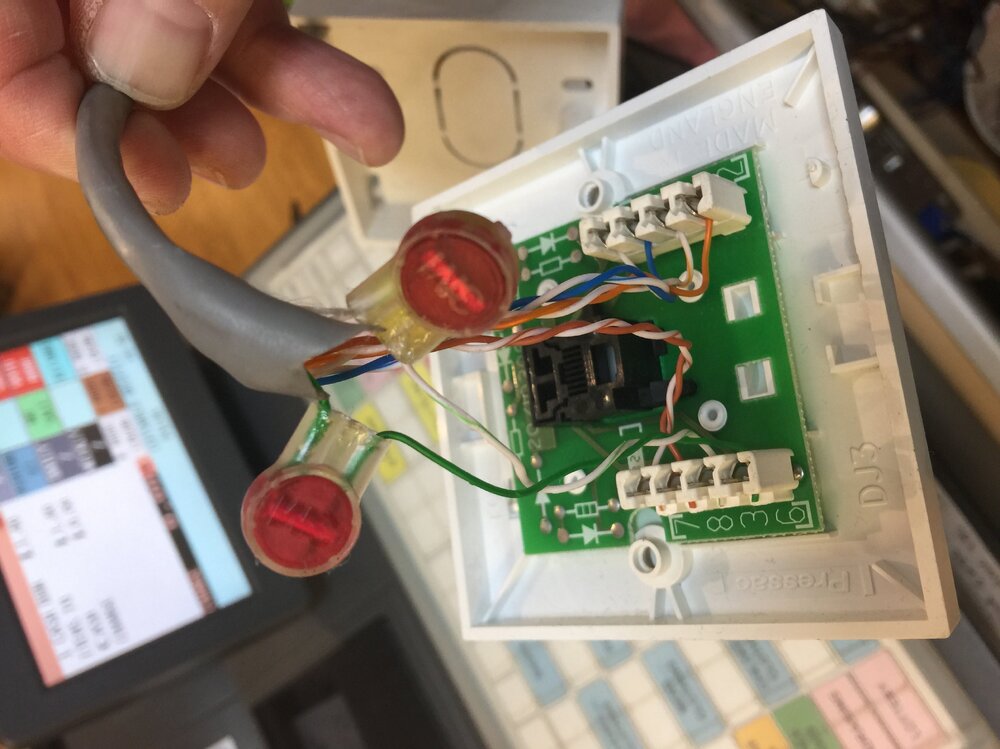

  13. You are correct Boredguy! Never seen these before in my life, and close inspection shows that the white/green cable is not very well connected! Fingers crossed, the new faceplate i have installed will resolve the issues!
  14. Morning everyone. In 20 years working in IT i have never come across this and I have worked with Cat5e all that time, but today, I went to change a faceplate and found 2 resistors on the green pair of the Cat5e. Does anyone know what they are for or why they may have been installed? We have had issues with this connection dropping out on a regular basis and am wondering if these may have been the problem? Thanks Wayne
