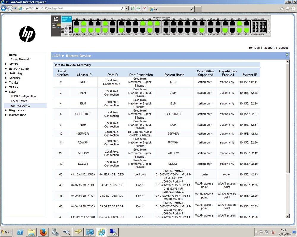

  15. Hi Guys I have been look at some LLDP software which I have found useful, just taken over a network which the cab looked like a bomb had hit it, plus 3 of the 5 patch panels where not labelled!! First one is a LLDP Discover Client, portable run it on a pc and will tell you which switch port it is plugged into, if the switch support LLDP that is https://github.com/chall32/LDWin Second one is a LLDP Services for windows clients, looks like a 30 day licence and I have contact the guy but no respones yet as his website doesn't have it to buy. Its nice I made a msi and rolled it out over the network and then on the HP switch you can see which pc is on what port Networking Software for Windows Hope this help other people as it has been very useful to me
