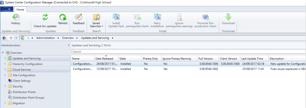

  8. We didn't install the update until the end of September

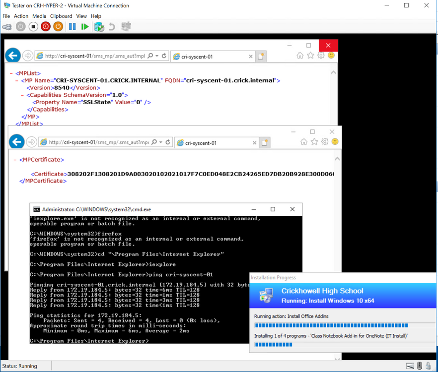

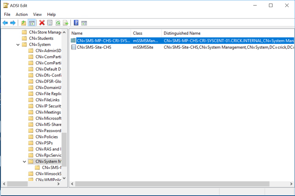

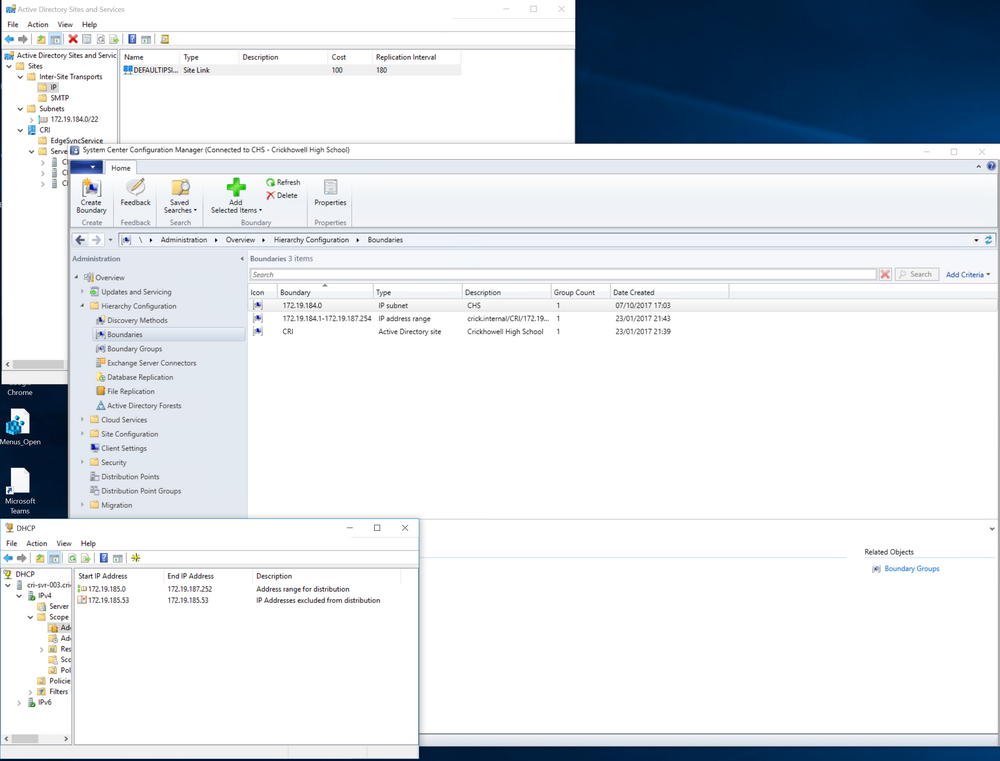

  9. Hi @Steve21, I'm still struggeling to figure out why it would of just stopped working. Apart from installing the 1706 update we hadn't changed anything. Screenshot of those pages, which load Firewall on the server is off while we try and resolve this issue. The user account we are using is the Domain Administrator account (bad I know but wanted to rule out that issue). Configure AD? Where do I go for that? Screenshot from ADSI This is our boundary settings, AD setting and DHCP scope. Note that DHCP only leases from 185.0, 184.0 is for static/reservation based devices.
  10. Right, no joy at all. How can I get the management point to be auto discovered again? I've removed and added the roll but that hasn't fixed it. Can only install the client via SCCM push it seems.

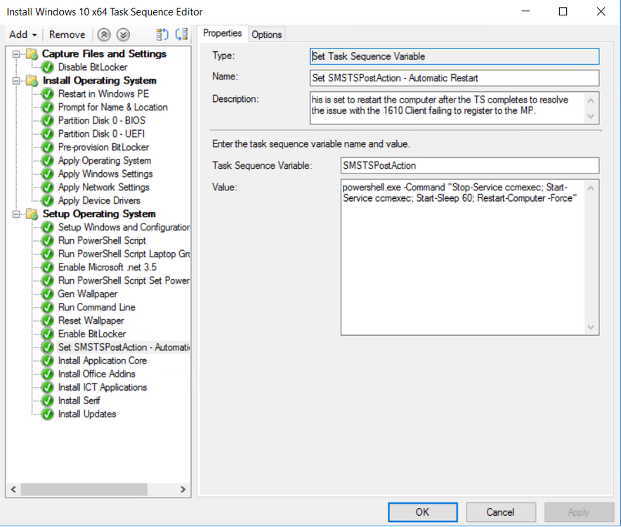

  17. Hi @Jamorie, We don't have any restart commands in our task sequence after the OS has installed. I removed those when the new ADK came out. I have now added a restart command in after it enables bitlocker to try and do something, but it seems to still hang on installing applications. The task sequence service stops, CCMexec is using a lot of CPU time and getting that error in the log a lot. This is what our task sequence looks like
