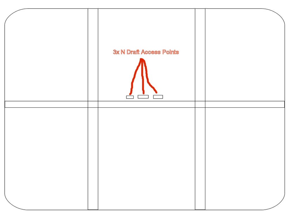

  20. Ok I've been having a think and wonder what you think of this plan. Upgrade laptop wireless cards to Ndraft Use 3x N Draft Access points in a central location Lock 20 laptops per AP with MAC address's Here is the side view of the building and my proposed plan, excuse the bad PSP ; What do you think, viable, workable?
