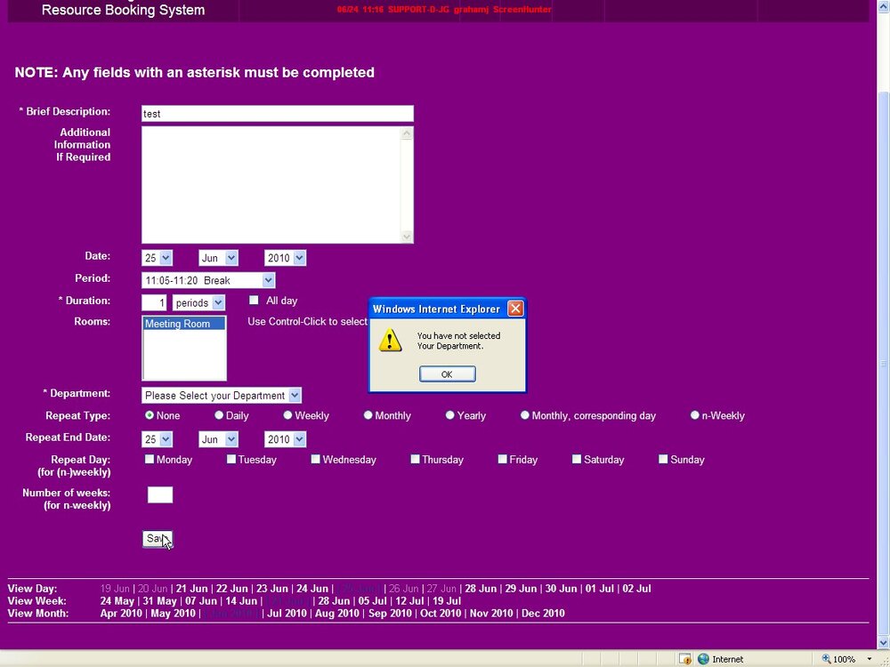

  1. Thanks for your replies guys, I have managed to do it now just by using a java script and a little modification in edit_entry.php with the drop down menu coding.

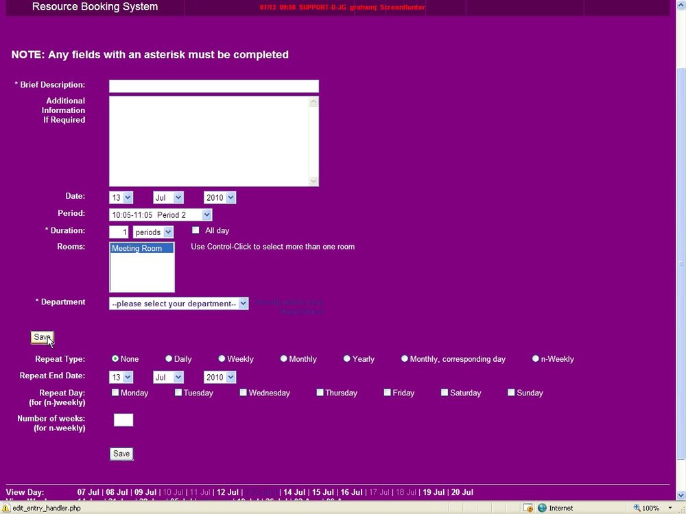

  2. Thanks for your replies guys I appreciate it, So far I have managed to force the error please select your department by using a jquery script, but unfortunately I can only get it to work with a seperate save button. I some how have to figure out how to link my script with the original save button. Thanks

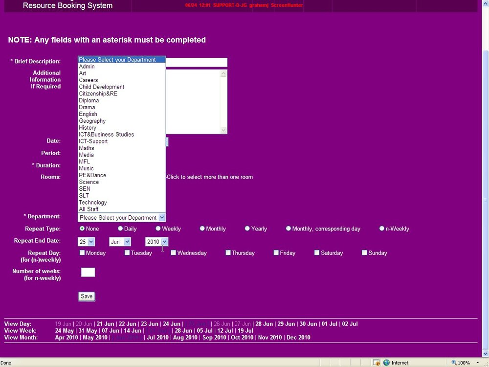

  3. Hi all I was wondering if somebody could help me with a bit of code, we are currently using mrbs and I have a bit of an issue with it at the moment when staff book a room they are not selecting there department and just leave it as default, the default entry is A in a list array which I have set to please select your department. what I want to do is to force the them to select any entry apart from default by throwing up an error if not selected I have managed to get as far as getting the error on screen but I unable to link it with the entry type. please see attached jpegs Modification 1 I have made in edit_entry.php <?php if ($type2 == "$c")?> { alert ( "<?php echo get_vocab("you_have_not_selected") . '\n' . get_vocab("your_department") ?>"); return false; } Modification 2 I have made in edit_entry.php <?php echo get_vocab("type")?>: <?php for ($c = "A"; $c <= "A"; $c++) { if (!empty($typel2[$c])) { echo " $typel2[$c]\n"; } } for ($c = "B"; $c <= "Z"; $c++) { if (!empty($typel[$c])) { echo " $typel[$c]\n"; } } ?> Modification 2 I have made in config.inc.php $typel2["A"] = "Please Select your Department"; $typel["B"] = "Admin"; $typel["C"] = "Art"; $typel["D"] = "Careers"; $typel["E"] = "Child Development"; $typel["F"] = "Citizenship&RE"; $typel["G"] = "Diploma"; $typel["H"] = "Drama"; $typel["I"] = "English"; $typel["J"] = "Geography"; $typel["K"] = "History"; $typel["L"] = "ICT&Business Studies"; $typel["M"] = "ICT-Support"; $typel["N"] = "Maths"; $typel["O"] = "Media"; $typel["P"] = "MFL"; $typel["Q"] = "Music"; $typel["R"] = "PE&Dance"; $typel["S"] = "Science"; $typel["T"] = "SEN"; $typel["U"] = "SLT"; $typel["V"] = "Technology"; $typel["W"] = "All Staff"; Has any body had any similar issues or know where I am going wrong with my coding. Thanks J
