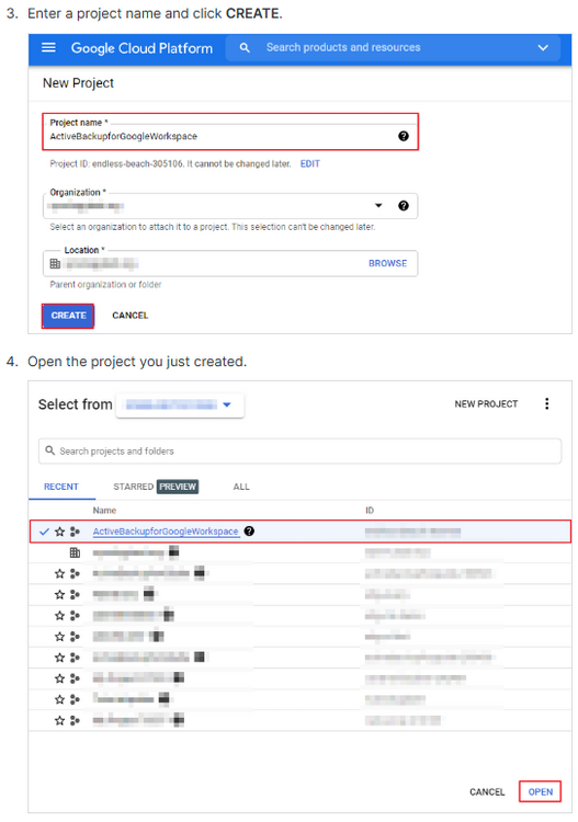

  6. Hi pete, thanks for your reply, I didn't realise there was a guide from Synology. I get stuck between step 3 and 4 in the guide, upon pressing 'Create', I get the permission error and so can't continue.

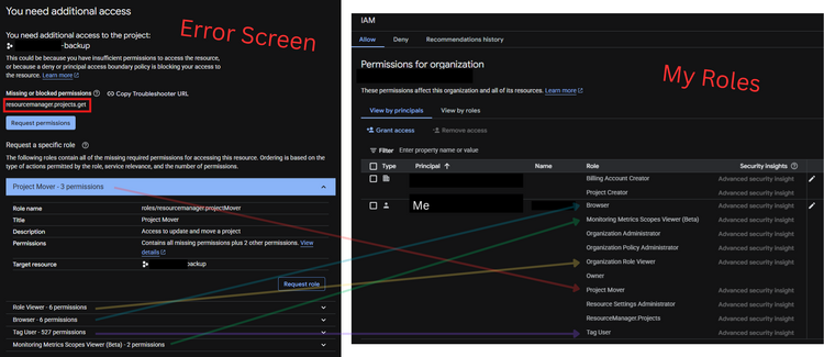

  7. Hello friends, I'm trying to set up a project in Google Cloud for 'Synology Active Backup for Google Workspace'. Every time I try to create a project, it fails with a 'resourcemanager.projects.get' permission error. As far as I understand I only need to add one of the roles suggested in the screenshot, but even when adding all of them I still don't seem to have permission. I've contacted Google but as the school doesn't pay for support they're not obliged to help, although their reply did mention roles 'resourcemanager.projects.create', 'resourcemanager.projects.get', and 'resourcemanager.projects.list.' I've created a custom role 'ResourceManager.Projects' and added these three permissions, as well as the original error permission 'resourcemanager.projects.get'. I've also turned off the enforcement for the "Disable service account key creation" policy, and checked to see if there were any deny rules but I couldn't see any. After adding the various roles and permissions, I still get the same error. Advice from anyone more familiar with Google Cloud than me (most people) would be greatly appreciated. Thanks Error Screen vs My Roles: My Custom Rule:
