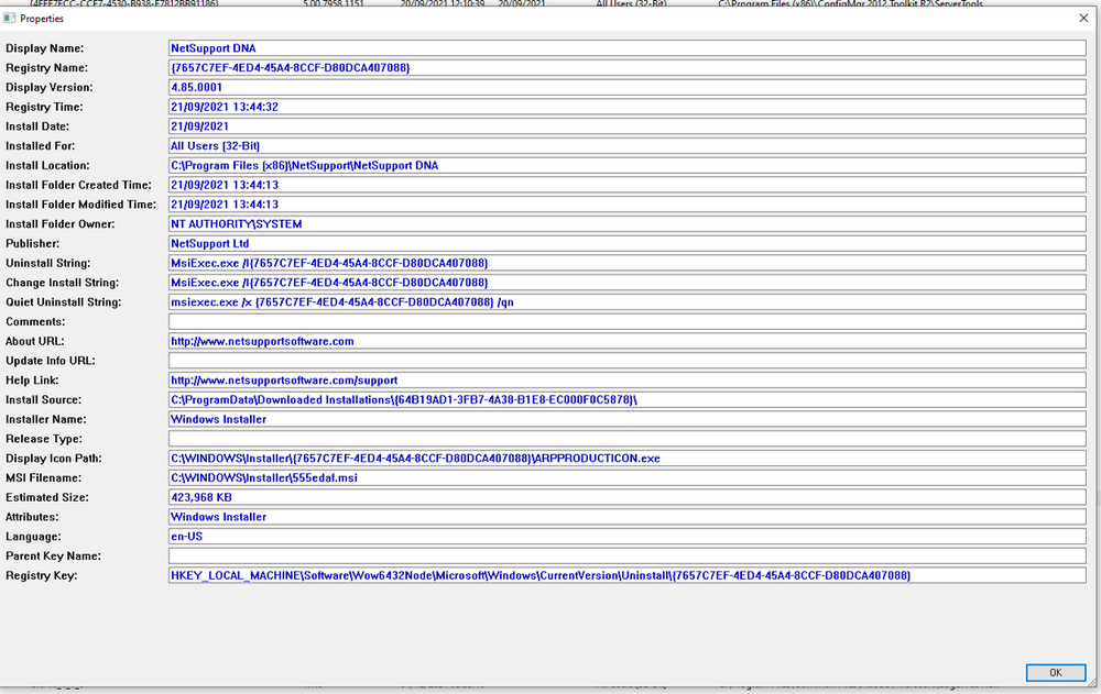

  6. A little nifty tool we found was uninstallview which lists all the install/uninstall strings for each program installed on the machine. This is an example of DNA installed on our machines, although it might be different for you depending on which version you have.
