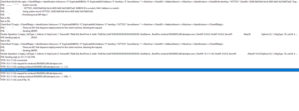

  1. Yea I solved it, adding ip helper-address for vlan, but now I have another problem, probably with image windows 10 or this: There are NO Task Sequence deployments for this client machine. Aborting the request.
  2. Ok I resolved it was ip helper for vlans on switches but now I have aborted but a small step forward This is log from SMSPXE.log: that's where the problem is because the new sccm is not where dhcp
  3. Hi everyone, I have a small problem with the boot of new windows 10 system image from new SCCM 1910 In our environment we have old sccm 2007 with DHPC, becouse it is used all the time, so I decided to create a new server with SCCM 1910, but without DHCP, and now my problem appears: how can I boot dhcp scope for the new server which I created, I tried to add options 66 and 67 and give the ip address and boot name there but it does not help in the SMSPXE logs: TFTP: 10.1.7.131 cannot open path to bootfile and on the computer monitor: TFTP: PXE-T00: Failed to open file. PXE-E36: Error received form TFTP server
