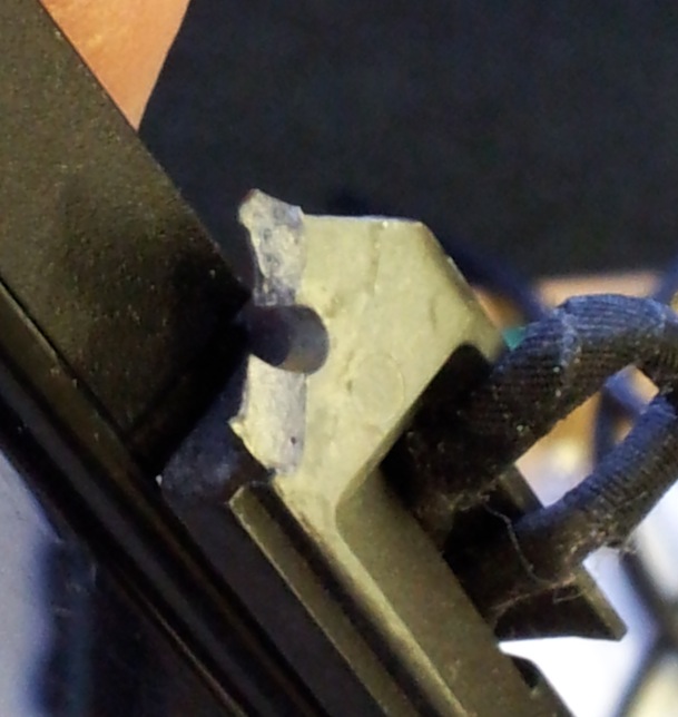

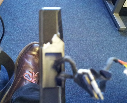

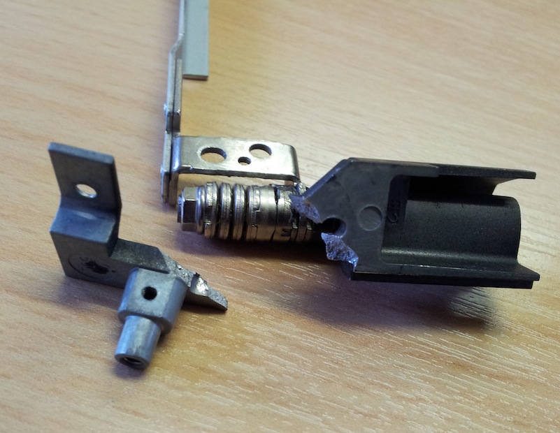

We have a few of these. So far, the left laptop hinge has snapped in exactly the same place snapped on 4 laptops. Jeff The Destroyer wasn't involved - this was general Open/Close use. It's always the left one because there's a overly-large hole right on a stress point.

All the leverage from the screen movement is borne by less than a cm of metal on each hinge. Only one side is anchored. There's no wonder they crack.
