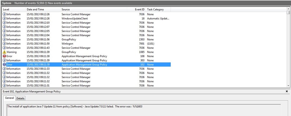

There have been a few java updates recently but im having problems with getting them installed. We get an error code 1603 in eventviewer and it tries to install on every boot. Running the .MSI manually it fails with an error 'The installation was interrupted'
This has been the case with the last few updates. I am creating a new GPO for each update and deleting the last. Security permissions are all set for workstations the same as any other software install.
I'm guessing the issue is because the msi is failing to install even manually but the last few have been doing this.
