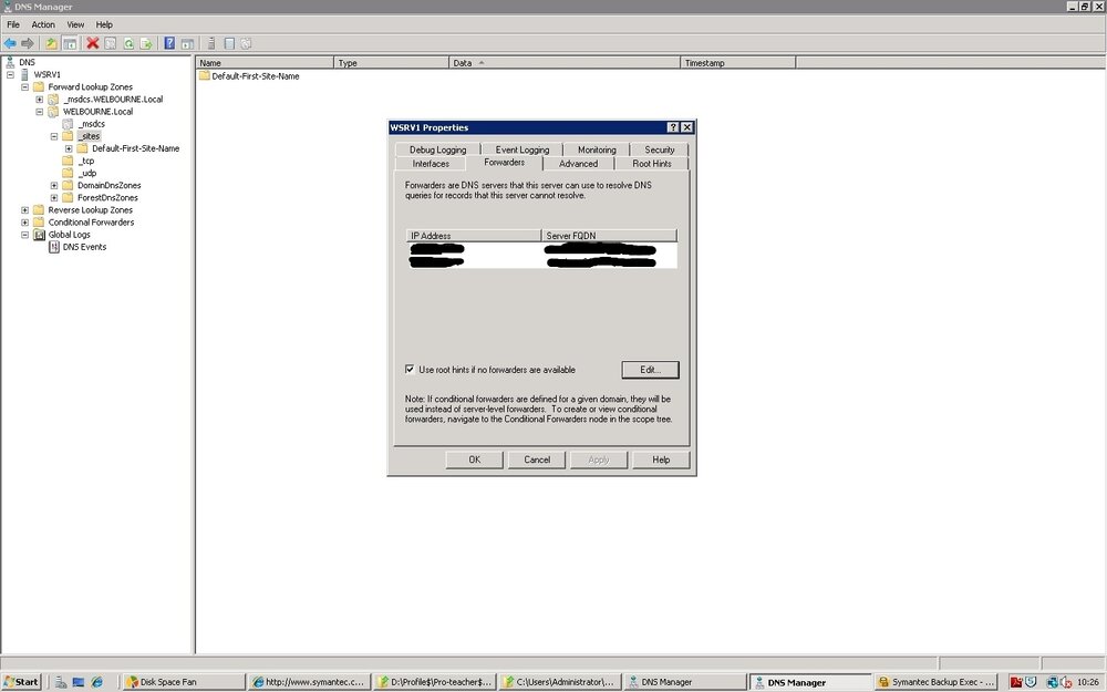

Hi Guys,
We are moving o LGFL2 soon. What Changes to make in server? how to Set DNS Forwarders to LGFL ones? .
please help. I have never did any change in DNS Server. Am I in Correct Place?

Hello ....
have a look in the support site ...... attend on of the free training course or failing that call the help desk and they will help you out
To answer your question yes set them to 172.30.178.53 & 172.30.178.54
If your not sure call the help desk to ask.
