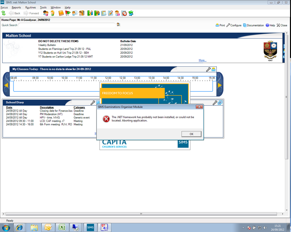

Can anyone help me with Exams organiser on 64bit installations, see attached screen print. This is effecting Win7 x64 as well as our remote access server running on server 2008R2. There is nothing wrong with our.net installation ive completley removed it and re-installed it. (if you try and open sims with out it it wont even load the login box so i know the Main sims.net application can find it.)

Any ideas on exams organisers?

Im under an LA support system that is less that helpful. The response i got was use a 32bit machine instead. Is this a common problem with x64 machines and exams organiser or is it just me?
Is Exams x64 compatible? Maybe it's looking for the old location where it would be on a 32bit machine.
Yes, 64bit happy. It's a 32bit application. It works fine in the c:\program files (x86)\sims\sims .net directory or whatever weird location you may decide. I believe it needs to register some COM files that means you need admin rights but other then that.
