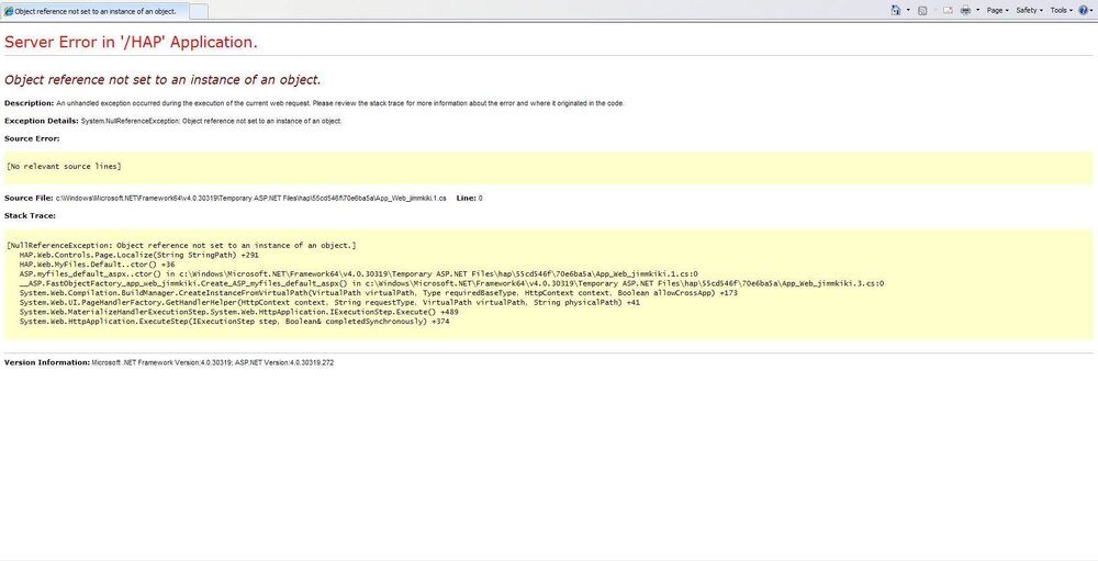

I have two instances of HAP installed in IIS.
One is a V7 install listed under IIS as HAP and the other is a V8 install listed as HAPBETA. I'm now happy with V8 and want to move it to the HAP instance, but when all files are removed from the HAPBETA folder to the HAP folder. It looks as though it has worked as you get the new login screen and you can log in ok but when you click on my files you get the attached error.
Should I be doing this another way?
Thanks,
Michael
Hi Nick,
en-gb was in the correct section in the config file. I found that the issue was because the IIS AppPool on the AppData folder was set to HAPBETA and not HAP.
It's working now.
