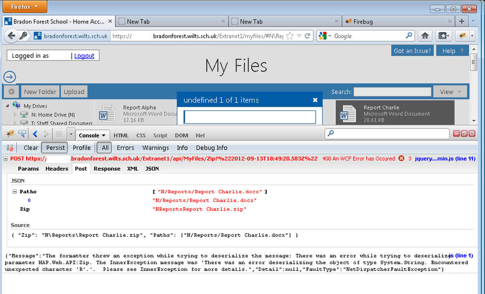

When in the root of a drive, you can zip a file without any issues.
If you go into a subfolder and try and zip a file it gives us as WCF error (output from firebug below)
~/scripts/jquery-1.7.2.min.js line 11
{"Message":"The formatter threw an exception while trying to deserialize the message: There was an error while trying to deserialize parameter HAP.Web.API:Zip. The InnerException message was 'There was an error deserializing the object of type System.String. Encountered unexpected character 'R'.'.  Please see InnerException for more details.","Detail":null,"FaultType":"NetDispatcherFaultException"}

The isn't really a difference in the screenshot to make it worth uploading.. only difference was in the source part, the line went from saying
{ "Zip" : "N:\Reports\Reports Charlie.zip", "Paths" : ["N/Reports/Report Charlie.docx"] }
to
{ "Zip" : "N:\Reports\Reports Charlie.zip", "Paths" : ["N\\Reports\\Report Charlie.docx"] }
I tried copying in the Zip function from version 7 of HAP and it generated the same error. Also tried it with the new code and less \\ so it displayed the path as N\Reports\Report Charlie.docx and it still told me to away and put the kettle on.

Amended both lines, but still getting same error message
Paths ["NReportsReport Charlie.docx"]
0 "NReportsReport Charlie.docx"
Zip "NReportsReport Charlie.zip"
Source
{ "Zip": "N\Reports\Report Charlie.zip", "Paths": ["N\Reports\Report Charlie.docx"] }
Tried a fresh copy of the default.aspx, and added the 2 line changes in, just to make sure it wasn't picking up anything else and still erroring, so see the attached image inc source code
