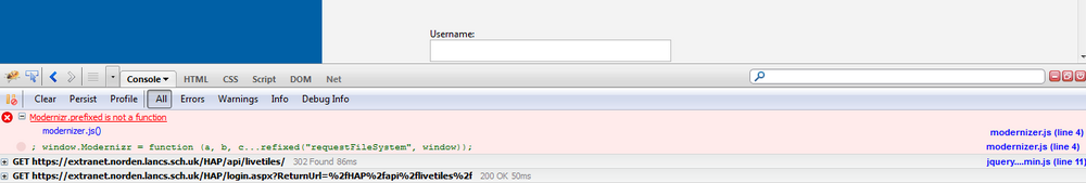

+1 with the refreshing thing. I haven't been able to get past this and get to a point where I can log in so can't comment on the other issues in the above post.

If you are able, use Firebug in under the NET tab to see what is causing it.
Make sure you go to the setup.aspx page when you've got it working to reset the web.config settings.
The modernizer issue can be ignored. It's odd it's trying to interface with the live tiles interface on the logon screen, which it should not be doing

Added these 3 mime type to the HAP directory within IIS but no arrow displays in IE9 - also done IISReset and cleared browser cache just in case...?
Right, I've found out that if i click on a link to our HAP site (from our website, or from the previous page on this thread for example), the login page displays with the arrow, but if i click the link from my IE favourites, or type it in manually then the arror doesn't show. Any ideas Nick?
