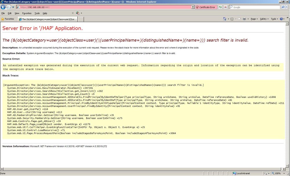

Oaktech Posted August 20, 2012 Posted August 20, 2012 Got a problem... Think i've done everything by the book, including the HAP identity permissions to HAP and appdata folders, which i had to set via icacls on command line. Initially i got the error about the SVG mimetype, but i just removed that line, i've never even seen an svg file on this network! After the certificate error, which I expect, i get the following error (see image) and I can't navigate to anywhere within the site. Help!

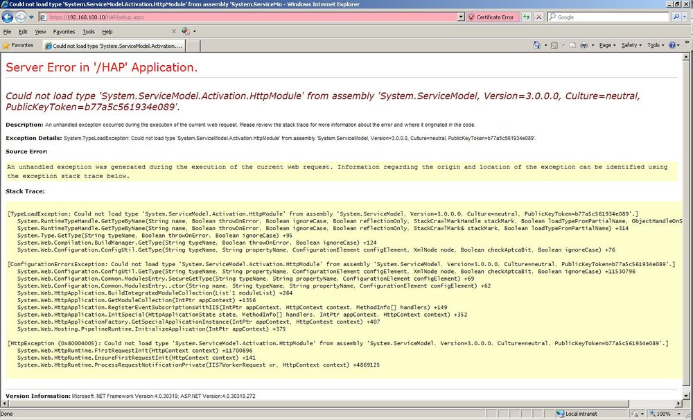

nickbro Posted August 21, 2012 Posted August 21, 2012 Reinstall .net 3.5 SP1 and then Repair .net 4 1
Oaktech Posted August 21, 2012 Author Posted August 21, 2012 Ok, done that... got this... I can browse setup.aspx but i get lots of red crosses.
