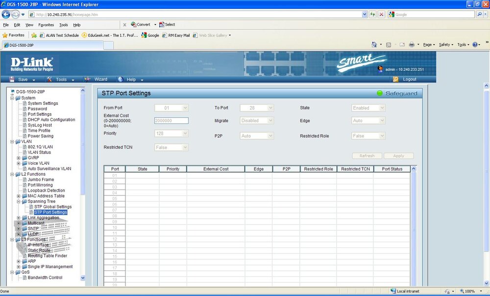

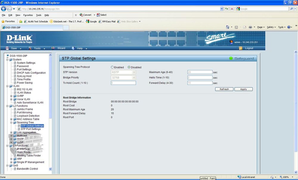

Spanning Tree is currently disabled on these two switches (I am not sure how the core switch is setup as it was installed and configured by our local LEA IT Support team and they don't give us the passwords to access it ourselves). I am on holiday for the next week so I will try to enable it on the two Link switches then to see if it makes a difference. As this is so new to me I have attached screenshots of the configuration settings available for spanning tree, other than enabling it do I need to change any of the other settings?
