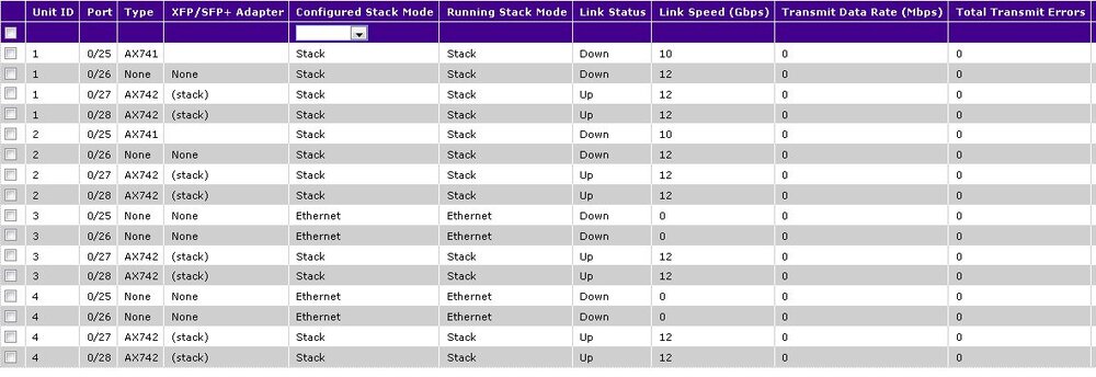

I have attached screenshots of the web interface with the status:
Now I think that should display a picture of a module (physically it's attached to Module Bay 1 on both, and the M1 light is off - which according to the manual no module is inserted)
and if you look into the Port list, it shows AX741 modules being inserted to the relevant slot (but not an AX743 - so it is sensing a module insertion)
