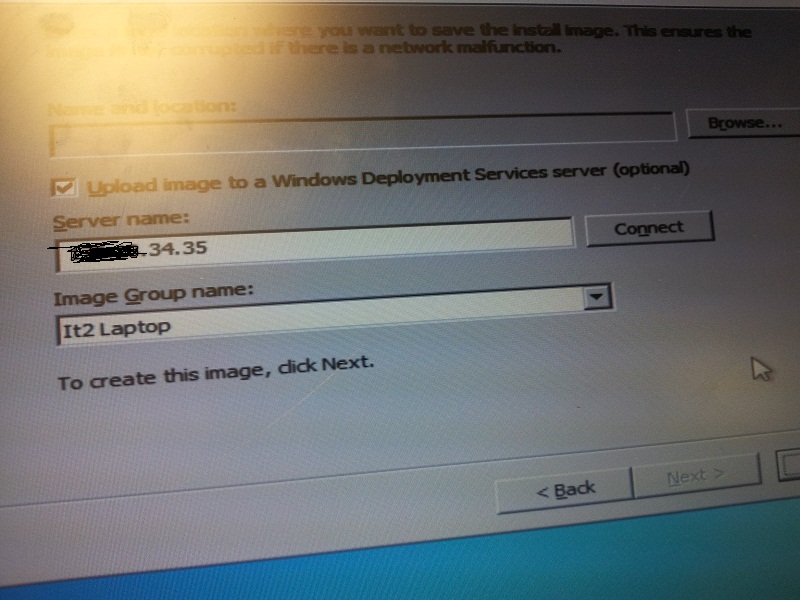

newpersn Posted June 20, 2012 Author Posted June 20, 2012 Right. Im stuck again. When trying to capture an image. It get stuck on trying to find the server. I redone the caprture image trying different drivers. I enter the servers name, Then i get a box asking me to log on. i select the image group i want to save to. and it wont let me click next.
sted Posted June 20, 2012 Posted June 20, 2012 worst case ditch copying it to the server then just copy the wim file from the local pc to the server and add it manually
newpersn Posted June 20, 2012 Author Posted June 20, 2012 worst case ditch copying it to the server then just copy the wim file from the local pc to the server and add it manually might try that if i cant get it to work. Thing is i got 33 computers on order and the due in soon. and would like to deply them this way aswell.

sted Posted June 20, 2012 Posted June 20, 2012 eureka even though you are uploading it to teh server you need to fill in the top part as well as it creates the wim file locally then copies. I create a folder called wim on the pcs drive (usully on that screen d: ) and place my image there called something like hp3800-win7x64-july12.wim

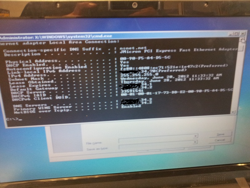

newpersn Posted June 25, 2012 Author Posted June 25, 2012 what do i need to add in to DHCP for it to work over Vlans?
SYNACK Posted June 25, 2012 Posted June 25, 2012 what do i need to add in to DHCP for it to work over Vlans? A DHCP helper on the switch/router should do the trick.
newpersn Posted June 25, 2012 Author Posted June 25, 2012 A DHCP helper on the switch/router should do the trick. What would i need to add?
