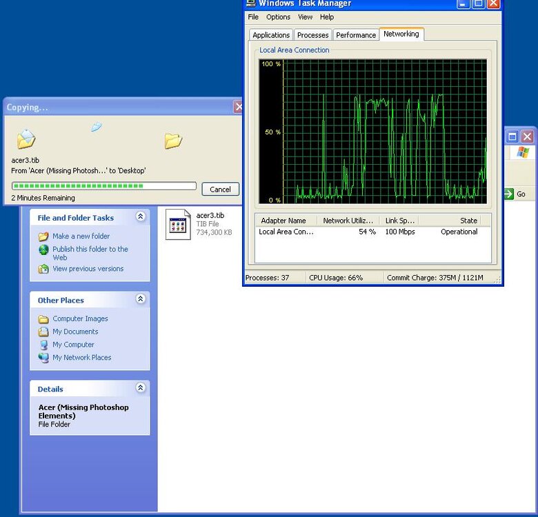

Morning just wondering If anyone has experienced this, my current set-up is 3 building, 1 has server, 2 then 3. I have a fibre connection from 1 to 2 then to 3. Connections in building 2 are great to building 1 but in 3 which connects via 2 we have very slow connections.
Done a few tests - 730MB file from DC02 to desktop of client.
To machine in building 2 - 1 min 25 sec
To machine in building 3 -6 min 29 sec and another machine in building 3 5 min 04 sec.
Can anyone help me with this one ?
Thanks in Advance James

Well think ive got to the bottom of it, the setup in Building 3 is 3Com switch with fibre then 2 switches that connect to this. Copied a file when plugged into 3com without fibre 7 min 28, but a direct connection into the 3com switch with the fibre less that 1 min. So Im 99% sure that is the root of the problem, my least fav job is changing switches :-(

Based on what you have said, I'm guessing that you have your switch connected to the fibre switch using Fast Ethernet (100 Mbps) ...is that correct? If so, how many other machines are connected to that (non-fibre) switch?

Well both are unmanaged I believe ill investigate, Mehmet your right, this is affecting both switches connected to the fibre switch, I've restarted both switches and ill report back.

Is this not simply a case of not having enough bandwidth, then? If you have a 100 Mbps uplink to the fibre with multiple devices connecting to that (non-fibre) switch, then there's no way you're going to be able to get the full 100 Mbps as you are limited by the 100 Mbps uplink (which I imagine is being shared by multiple devices). What you could try doing is disconnecting all devices from the non-fibre switch except from one host, and then try the transfer from that single host.
