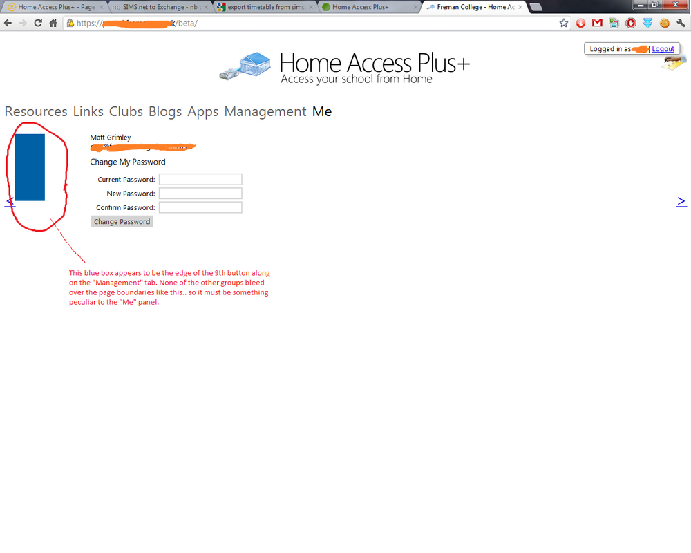

(Before i go though, once i've populated my groups, i'm getting the contents of the "Me" group being displayed at the bottom of the first group. It all seems to work still, but just displaying in the wrong place.. I noticed it earlier, but it went away when i reverted to your example groups - I have a bit more in my groups and can dm them if required...)

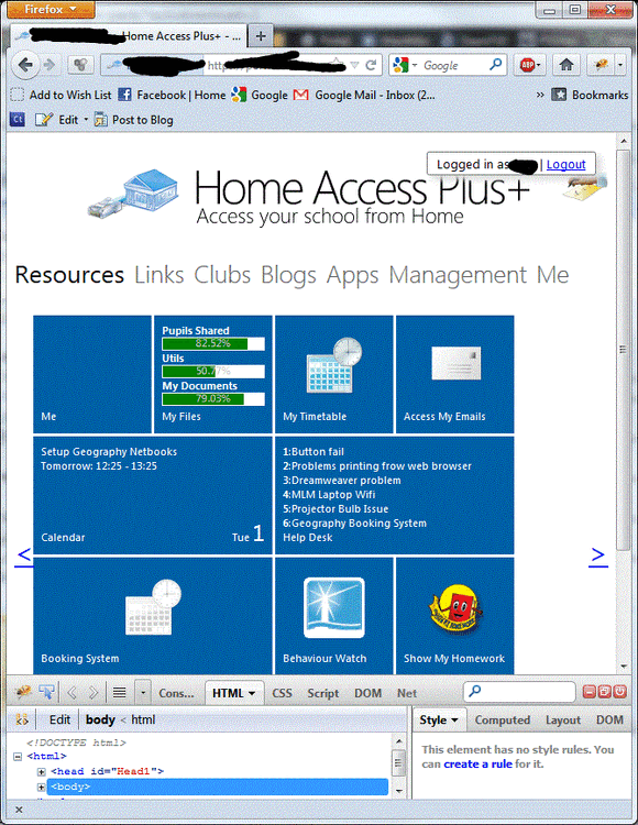

Very odd, I just added a few groups and can't get it to duplicate it (had 10 groups running).
Any chance of getting access to that page to do some firebug debugging? If you know how to use firebug (I think chrome dev tools do it too) to inspect the CSS & HTML on that div to see what's causing it to do that.

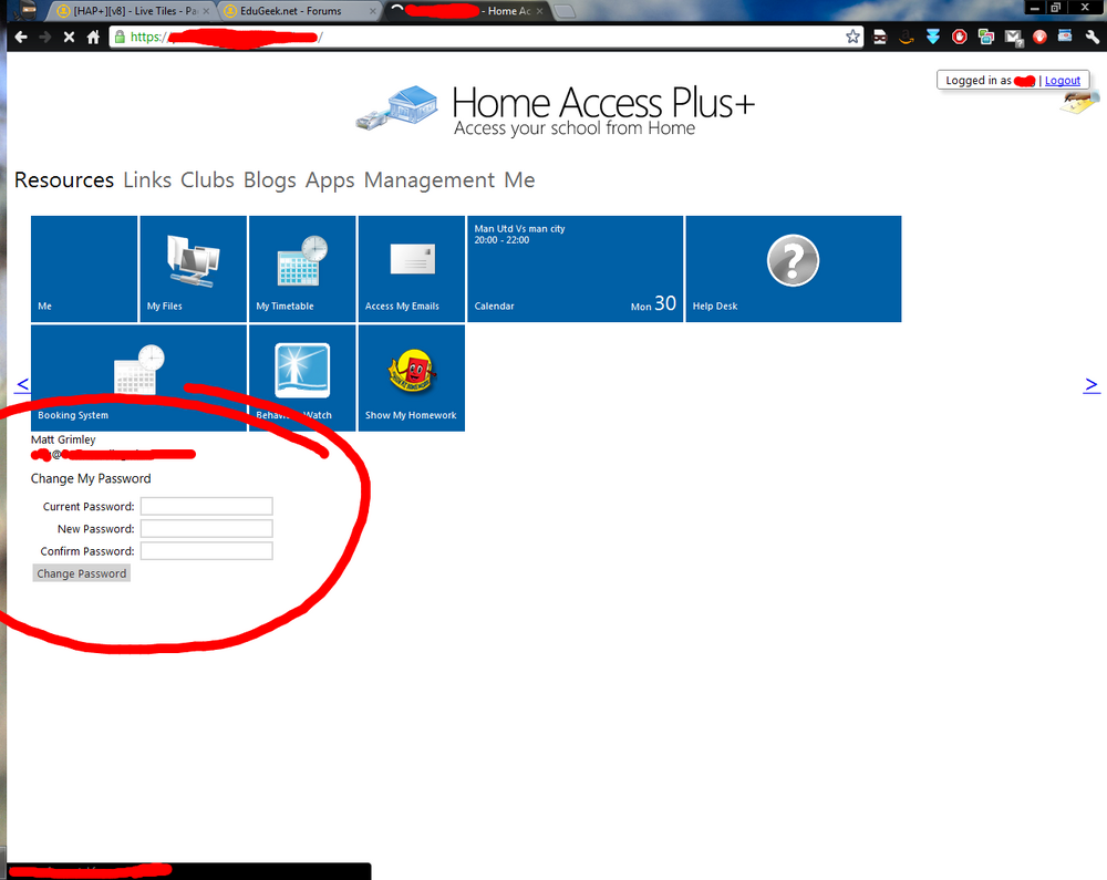

Hey Nick,
Attached is a screenie of the "Me" panel after manually reducing its width. You can see on the left hand side, half of a button which has carried over from the top row of the "Management" panel which is what is causing the problem:

On the Live Tiles issue, hmm, how to fix that....
Undo the changes you made the default.aspx file and try these changes instead (default.aspx file):
Replace
$("#HomeButtons").css("width", ($("#HomeButtons > div").length * $("#HomeButtonsOutter").width()) + "px");
with
$("#HomeButtons").css("width", (($("#HomeButtons > div").length * $("#HomeButtonsOutter").width()) + 20) + "px");
increase the 20 as needed to get the me tab to fall back into alignment, let me know on the outcome and I'll add it to source control

Well, good news and bad news..
Changing that to 200 makes it look perfect.. when full screen..
Now to move the goal-posts..
When the browser is not full-screen (as in the screen-shot below), the start position of each "panel" shifts to the right by about 20 pixels per panel.. That should be visibile in the animated gif below.. if it works!
