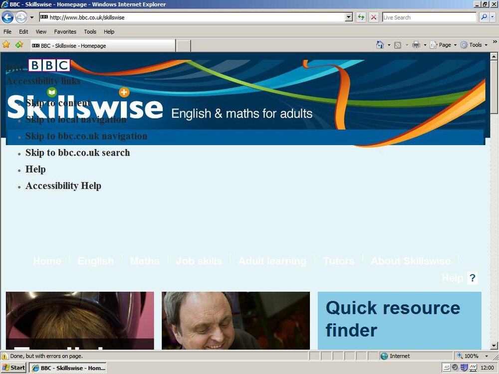

this seems to happen at random times no other sites are affected can anyone shed any light on this are you having issues)
seems to happen on the skillswise section at the moment

[ATTACH=CONFIG]13345[/ATTACH]

no we are on yhgfl probbably linked somehow
problem has only appeared since they went to fullblown smoothwall
ummmm....caching problem perhaps?
It looks like an element isn't being displayed correctly or there is a another domain there being blocked. Check the smoothy logs.
For me adverts are block so I don't see the top banner, the smoothy logs confimed this. The rest loads fine.
