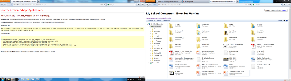

mdench Posted January 3, 2012 Report Posted January 3, 2012 Sorry if this has been answered else where had a search but couldnt find anything related.. Got Hap all set up works great can browse directories, rename and move files and create new folders but when i try to download files from HAP i get the following error... Any ideas whats causing it?
mattgrimley Posted January 3, 2012 Report Posted January 3, 2012 http://www.edugeek.net/forums/home-access-plus/82823-home-access-plus-v7-2-outstanding-issues.html Specifically; "7 Config UI writes server shares as //servername/share rather than \\servername\share causing "given key was not present in disctionary" errror in browser" Check your hapconfig.xml file and ensure that the slashes are the correct way around!
glennda Posted January 3, 2012 Report Posted January 3, 2012 so should the slashes be \ or / ? just looking at the hapconfig and all the slashes are \\svr\share_name
mattgrimley Posted January 3, 2012 Report Posted January 3, 2012 Yeah, that is the correct way, so it is not the same cause as mine was Just incase there is a typo or some such, my section from hapconfig.xml looks like this: %homedir% \\servername\pupilsshared \\servername\teachersshared Otherwise, you need help from someone more capable that me!
nickbro Posted January 3, 2012 Report Posted January 3, 2012 The address bar, any chance you can change the lowercase n to an uppercase N. The drive mapping letters need to be in uppercase
mdench Posted January 3, 2012 Author Report Posted January 3, 2012 awesome thanks alot just changed it in the xml config to an uppercase N and works perfectly
nickbro Posted January 3, 2012 Report Posted January 3, 2012 I've added additional javascript into the setup.aspx page to convert the drive letter to uppercase always
